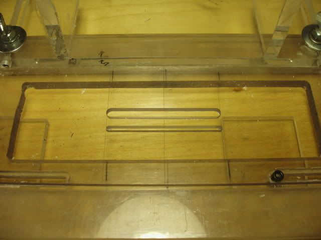

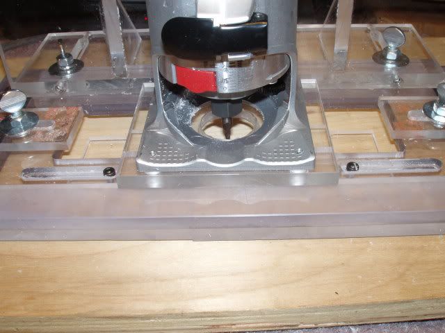

Mine's mostly for redoing saddle slots on the guitar, but works fine with a new bridge dblsticktaped to a surface, too. The router is a Bosch Colt w/clear subbase; part of the metal base has been cut away, since I took these photos, to see the work better
The second photo is the "target plate", set for 1/4" & 1/8" bits. I use endmills, recently got a 3/32"
one that I like; I bushed it up to 1/4" with telescoping brass hobby tubing, slit so that it will compress.
https://soundcloud.com/jeffreylsuits/he ... -runnin-13
