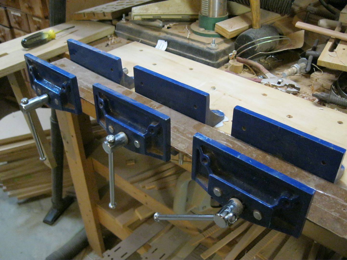

We use Original TiteBond -- for neck laminations and every thing else, musical instruments and furniture -- for decades. We do have a special vise set-up for clamping necks which keeps all the parts straight and true. Without such a device the water in the PVA can cause weird things to happen.

We make and sell a lot of laminated necks, one thing we discovered is that its necessary to have a glue up clamping fixture that prevents warps/twist from occurring. We use an array of bench vises that are aligned and squared up, then add "F" or "C" clamps along the edges --- also makes the lay up much easier. I use Titebond Original and follow the manufacture's recommendations, we do not wait for weeks to use the blanks, that has never been necessary.
Ken Cierp

That's an effective looking set up, Ken. I've got one vice on my bench, but it is flush mounted. I have a pair of old screw to the bench type vices that will work, along with dozens of bar and f clamps.
I'll drill a reference hole through all the lams at each end, and put a piece of wire hanger in it for alignment.
