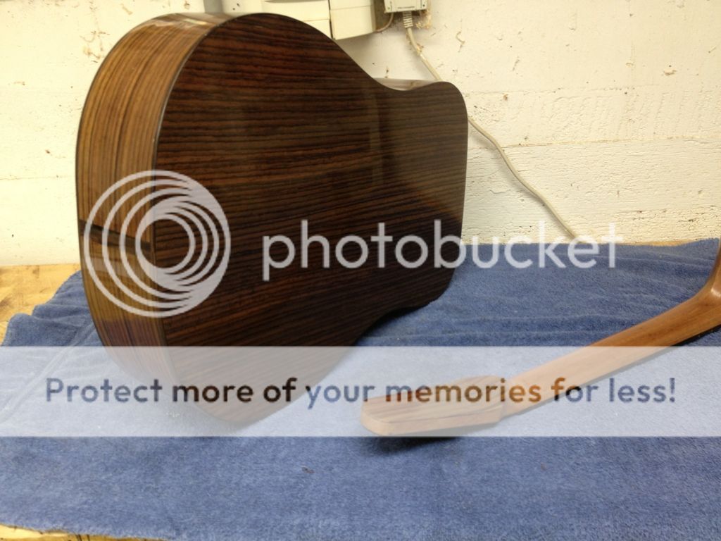

You don't need to seal the wood after pore filling with eggwhites as the whites act as an adequate sealer. Here's a rosewood guitar I made that is pore filled with egg whites and finished in KTM-9
