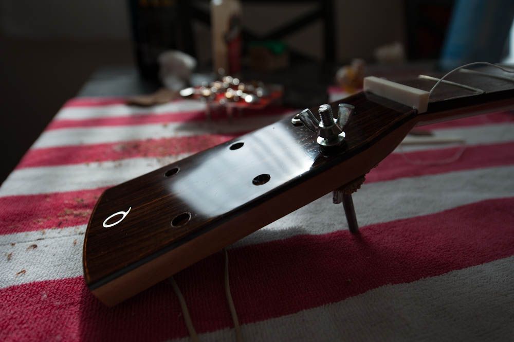

Take a 1" x 1" x 3/4" piece of hardwood or plywood and glue a 1" x 1" piece of cork to it. Drill a !/4" hole through the center as to make a "wooden washer". Get a 1/4" x 2" carriage bolt and insert through wooden washer. Put the washer and bolt through the headstock from the back. Put the bushing over the bolt followed by a nylon washer and wing nut and tighten to press in.

Hi, here is my home made clamp:
It works like a charm 8-)

Fred Tellier has it right. It doesn't have to be complicated. Your thumb will do it just fine. But if you are after a mechanical means to seat the bushing, then I highly recommend the wing nut method, as has been described and illustrated by others already. DO pad your wing nut with a washer or use a cork-lined spool clamp to avoid marring your bushings. Note: The truly important part of this is to have your bushing holes reamed out just right. And that can be determined by trial and error with a piece of scrap that is drilled out to the same diameter as the holes in your head stock, and then marking your reamer with a bit of masking tape.
