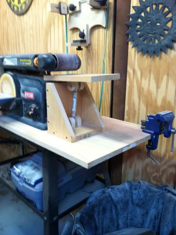

Here's a bad cell phone picture of mine.
Chris.
PostPosted: Tue Feb 14, 2012 10:07 am
Location: Raleigh, NC
Last Name: Sollod
This is what I'm talking about... Those are some interesting designs. Chris, I was thinking that a turnbuckle could be used to adjust the height (thickness). Does anyone else have a design to share before I attempt to make one?

PostPosted: Tue Feb 14, 2012 11:36 am
Joined: Wed Mar 19, 2008 11:49 am
Posts: 897
Location: Northen Cal.
You could do like Chris but use threaded rod. The rod would go into a thick block so you would have some travel and the rod would still be inside the block. Have two nuts, one to adjust height, the other to lock. Or one coupler nut with some blue lock tight or one of those lock nuts with the nylon inside.

PostPosted: Tue Feb 14, 2012 11:48 am
Posts: 3444
Location: Alexandria MN
I found an old picture of mine. I used 1/2" threaded rod. I'll see if I can find a better picture of the mechanism.
PostPosted: Tue Feb 14, 2012 1:28 pm
Posts: 3308
First name: Bryan
Last Name: Bear
City: St. Louis
State: Mo
When I made the table height adjustment for my thickness sander (same principle) I used threaded rod and imbedded a coupling nut into the loser brace and put a hand wheel on the rod. If I had been thinking more clearly, I would have used a tee-nut instead of a coupling nut, I think that would have been much easier.

PostPosted: Tue Feb 14, 2012 1:33 pm
Joined: Sun Nov 29, 2009 1:18 pm
Posts: 292
First name: Chris
Last Name: Wood
City: Chester Springs
State: PA
Zip/Postal Code: 19425
Mine works fine. Were I doing it over again I might fabricate a way to lock it in position. It's never moved, but I always worry it might.
