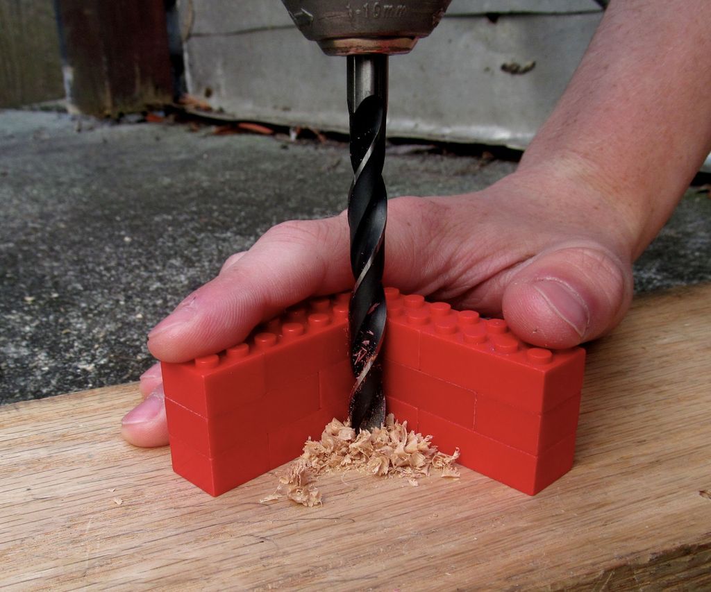

Alternatively, raid the nearest toy box. :shock:
