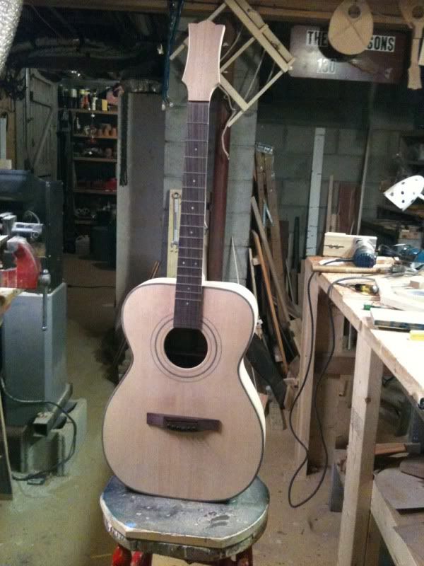

Hey,
This is my second guitar ( seventh instrument) I've made. I made a dreadful mistake and didn't put the the bridge plate back far enough, so the bridge pins just rest right past where the plate ends. Any recommendations? Even though this is a kinda crappy solution, I think im going to glue in an extension to the plate and drill through that. Is there something better I could do at this point maybe?
And just to show you guys the guitar, heres a couple pics
Nils

PostPosted: Tue May 10, 2011 11:46 pm
Posts: 1271
Is the X-brace where it's supposed to be or is the entire bracing pattern off in relation to the bridge?
If everything is right but the patch, just remove the patch and put in a larger one.
If the X is off then it depends mostly on where it intersects the bridge as to whether to re-top it or come up with another solution.

PostPosted: Wed May 11, 2011 12:42 am
I did this my 3rd guitar I'd built. It was a 12 fret and I'd not fully taken into account the length differences. I was too hasty and didn't draw it all out before proceeding. Lesson learned!
I removed the plate and replaced it. Quite the chore, but I was afraid of just putting an extension, and having a "hinge" of sorts right underneath the bridge.
PostPosted: Wed May 11, 2011 1:52 am
Posts: 1271
John Mayes wrote:
.... I was afraid of just putting an extension, and having a "hinge" of sorts right underneath the bridge.
Yes, that's a brace I would want to be in one piece.

Todd Stock wrote:
Options:
1. Extension plus a laminate over both original and extended bridge plate (e.g., .105 extension plus .090 laminate over everything)
2. Remove back and replace bridge plate
3. Replace bridge plate working through soundhole
4. Re-top
I would do #4 if it were my instrument, but knowing that the first few guitars are usually pretty much just woodworking projects, #1 may give you a playable instrument that is not much worse than what #2 to #4 would give you. Ken's too polite to mention this, but #4 would also give you an opportunity to rethink your rosette choices.
I think im going to go with #1. I hadnt thought of putting a laminate over the extension.

PostPosted: Wed May 11, 2011 7:26 am
Joined: Tue Aug 19, 2008 12:17 pm
Posts: 534
"Ken's too polite...", a problem that Todd has never had!
One thing you have to learn around here is that while some may have excellent technical skills, their arrogance knows no bounds.
Your rosette is fine, looks good on the guitar. It may not be Todd's choice, just don't let him play it.
I think the patch extension with overlay is a good solution at this point. It's your second guitar, finish it and play it, your next one can be better.
Joe
PostPosted: Wed May 11, 2011 8:39 am
Posts: 1310
Location: Michigan,U.S.A.
I would go with a pinless-bridge at this point. And would extend the plate with a extended plate before retopping.
PostPosted: Wed May 11, 2011 8:42 am
Posts: 3444
Location: Alexandria MN
Incidents like these are great opportunities to learn a new skill. Especially if you plan on doing this stuff for a long time. I'd give a re-top or bridge plate removal through the soundhole another thought. There's lots of info floating around on how to do both and I'm sure folks here would help as well.
PostPosted: Wed May 11, 2011 9:26 am
Posts: 7539
First name: Ed
Last Name: Bond
City: Nanaimo
I'd be worried about what a .195 bridge plate would do to the sound. I've never done it mind you, but that seems like an awful lot of wood to have in that particular spot. I give another vote for replacing the bridge plate.
PostPosted: Wed May 11, 2011 10:56 am

I would extend the plate,
then put a very thin, and small piece of lignum vitae as a patch.
1/16" x 5/8" x 2 3/4",
or so.
Re-top if it doesn't work,
but it will.
PostPosted: Wed May 11, 2011 11:16 am
Posts: 2692
Retopping is way into the overkill range for this guitar.
I would replace the plate, but I have experience with plate R&R.
You will be OK with an extension and a laminate over that. Just laminate over the joint and pin area; it doesn't need to cover all the original plate.
Don't use lignum vitae.
Howard Klepper
http://www.klepperguitars.com

Why not, Howard?
PostPosted: Wed May 11, 2011 2:57 pm
Joined: Sun Jun 21, 2009 1:08 pm
Posts: 426
First name: jim
Last Name: mccarthy
City: ojai
State: ca
Zip/Postal Code: 93023
Country: usa
Lignum V. is awfully heavy and it doesn't adhere well.

It's a tiny piece of wood,
that doesn't weigh much,
and the string balls are pulling it up anyway,
so?
PostPosted: Thu May 12, 2011 12:55 am
Posts: 713
First name: nick
Last Name: fullerton
City: Vallejo
State: ca
Zip/Postal Code: 94590
Country: usa
It looks like you could easily remove the bridge and then heat up your plate area to remove it too, since there is no finish yet to worry about, Then cut a new plate to fit where it should and glue it in. The tricky part is of course fitting your hand into what looks to me like a small diameter sound hole. If it were me and I couldn't do this I'd widen the hole. I like them bigger anyhow. It shouldn't be any harder than repairing a brace really. My two cents.
PostPosted: Thu May 12, 2011 5:49 am
Posts: 4915
Location: Central PA
First name: john
Last Name: hall
City: Hegins
State: pa
Zip/Postal Code: 17938
Country: usa
pulling a plate is not that difficult. There are 2 ways to do this. One is to take a wet cello sponge that is cut in the shape of the plate , lay it on the plate and let set for 24 hrs and check. Sometimes it takes 2 days to soak through the maple . The plate slips off nicely. The other method is to get a plate heat blanket and apply heat . Set it for about 250 degree and in 10 minutes it should be off. You clean off the glue and make a new one .
Many ways to do this . Pick the way you would like to go about it . I find artist pallet knives a good took for working under the plates.
John Hall
blues creek guitars
Authorized CF Martin Repair
Co President of ASIA
PostPosted: Thu May 12, 2011 9:20 am
I'd be worried that enough heat to remove the bridge and plate (if heating from the top which may be an incorrect assumption on my part) would separate the top seam and possibly the bracing...I'm leaning in Howard's direction even though I'm clueless about the lignum v... :D
PostPosted: Thu May 12, 2011 11:29 am
Posts: 2692
alan stassforth wrote:
Why not, Howard?
Hard to glue. More overkill.
Howard Klepper

FWIW, my 1955 Gibson has a bridgeplate extension.
PostPosted: Sat May 14, 2011 2:13 am
Posts: 766
I was just going to mention that. Loads of Gibson have bridge plates placed incorrectly, or from design changes mid production.
