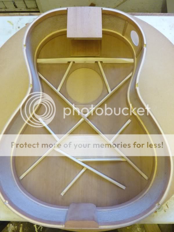

I have often thought about using a Spanish style head block glued in with the normal style SS construction method (sides not let into the block) and a M/T style neck attachment. The advantage is some of the rotational force of the string pull would be shouldered by the block and this would hopefully help prevent (or at least slow down) future neck resets. The disadvantage is that you are adding an noticeable amount of weight to the body.
I just haven't got around to trying it.

Randy Reynolds builds this way - steel strings and classicals. Big "C" block as a neck block, with bolt-on neck - two bolts, no M&T. Works like a charm and sounds great. Super stable and great if anything ever needs to come apart. I plan to adopt this approach, but I'm still building various constructions just to go through the experience.
Filippo
And Colin S too, if I'm not mistaken (though with a mortise for the supporting block under the fingerboard extension). I've built a few this way, but they haven't been around long enough to draw any conclusions. It sure is a simple and reversible way to build.

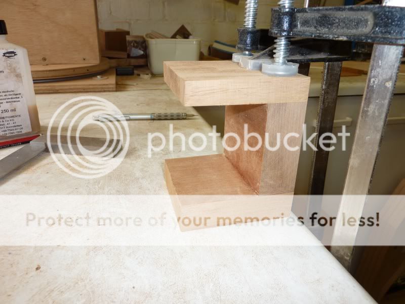

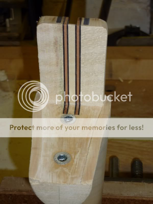

Yes I've used a 'Spanish heel' type of extension together with a fingerboard support that a neck extension is morticed into for about 30 guitars now and never had a hint of anything trying to move.
I think that a large number of builders ignore the importance of the neck block, it is a key component of the instrument, all of the major components attach to it, and just using a block of wood seems to be underthinking it. I use three piece 'C' blocks so that the grain direction follows the main attached piece. This ones upside down, the thicker part glues to the top.
I use a butt joint with an extension of the neck morticed into the top of the block.
This makes a very solid set up, with the advantage that the neck can be removed with just the two bolts.
Brock, as I don't need to make the block thick enough for a traditional or dovetail tenon on the neck to be morticed into, this block is no heavier than a conventional one, the mass is just redistributed.
