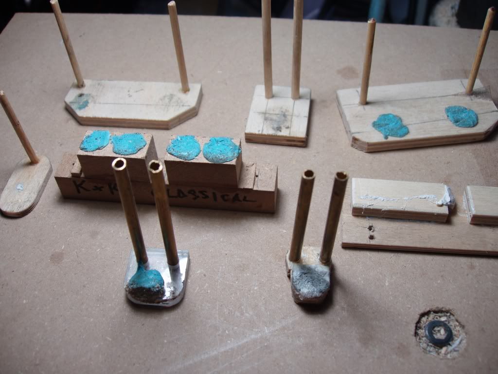

I install a lot of K&K PWMs aftermarket, always passive. Their pure classic system, for nylon string guitars, is quite the ear pleaser; I get consistent referrals from classical players.
Tip: don't use the supplied gel superglue, use a medium superglue. Better coupling with the bridgeplate/top. Spray some superglue accelerator on a piece of paper towel or cotton ball before you install, wipe the contact area, wait for it to dry.
Furthermore: a piece of plastic mirror inside the guitar, and a CF light dropped inside, make installs much easier.
I have a handful of templates that I use, which I'll take pictures of, and post, later.

The classical templates are pulled up to the top, by fishline or E string, through a couple of tiny holes drilled in the saddle slot.
