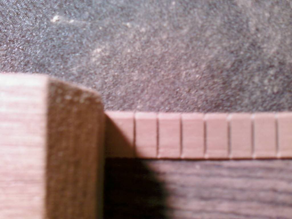

I went ahead and sanded it and this is what it left me with. I think its ok. what do you guys think?
(sorry the pics are not good )
Bro. Matthew A.
Oklahoma
PostPosted: Thu Feb 11, 2010 2:02 pm
Posts: 622
Location: Santo, TX
Can't tell much by the pics. It "looks" like your neck block is standing proud of the sides?
Bottom line...if the method you're using (I assume a radius dish) is making contact everywhere - including the linings and the entire top section of the neck block - you're fine. If not, keep sanding. Use pencil or chalk or some other medium to check your progress.

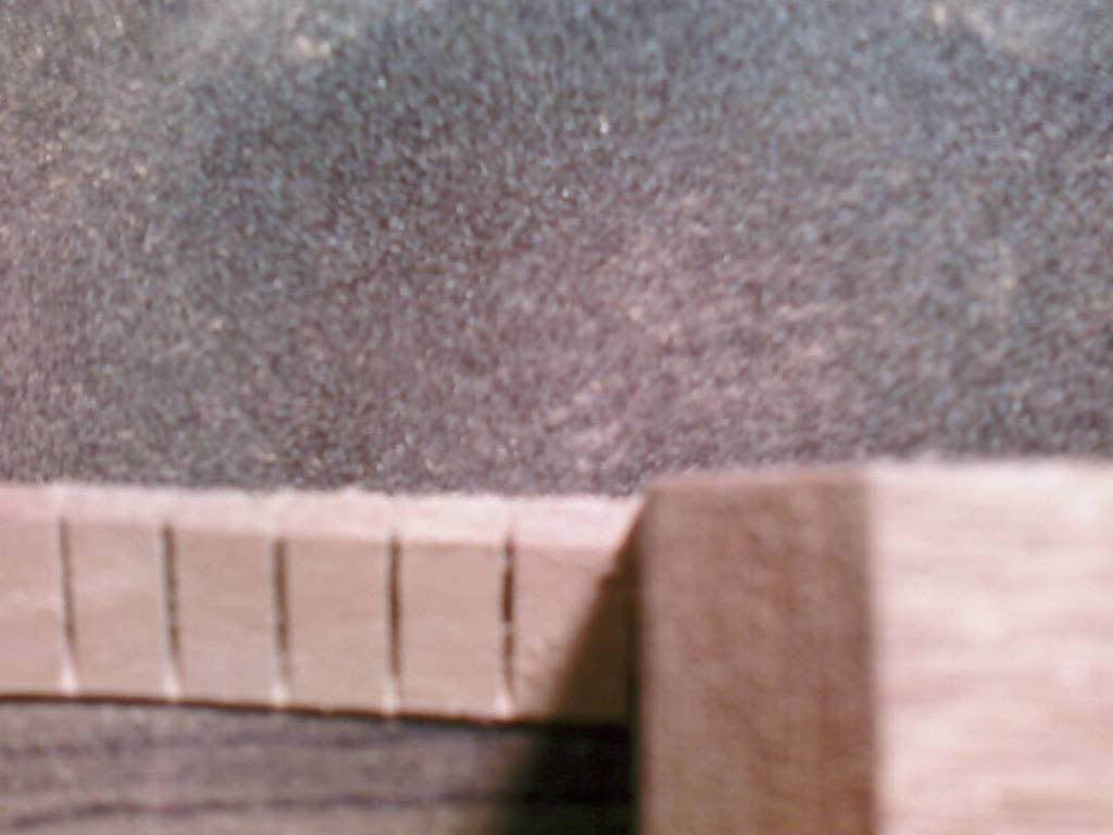

PostPosted: Thu Feb 11, 2010 2:31 pm
Joined: Thu Feb 21, 2008 3:09 pm
Posts: 149
Location: Tulsa, OK
Sorry, this pic is bad. Everything is in contact with the sanding dish. I wanted to show in the pics what was left of the kerf lining after all that sanding. I think it is enough. Do you?

PostPosted: Thu Feb 11, 2010 3:28 pm
Posts: 622
Location: Santo, TX
Structurally, you're fine. You have the full with of the lining left to glue the top to. The loss off the height won't hurt anything. Visually, it's up to you. It's on the top, so you can't see it through the soundhole (maybe through a soundport). If it bothers you, chisel it off and redo it. Won't take long.
