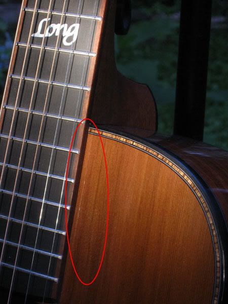

That's really outstanding. How long are the radial pieces?
PostPosted: Tue Jun 02, 2009 10:40 am
Posts: 588
Hey thanks, Waddy... the pieces are about 4 or 5 inches long. I install them the same way you do shell... with a teflon strip.

Bob Long wrote:
I took some photos tonight of a "Single O" guitar I just finished... I used Todd Stock's idea for radial purfling on this guitar, and so I thought I'd share them.
Cedar top with Zebrawood purf... I love the look! Thanks to Todd for the idea!
long
This isn't a crack is it?
PostPosted: Tue Jun 02, 2009 12:07 pm
Posts: 588
Rod... That's a reflection of the edge of the fretboard.

Chris aka Sniggly wrote:
I don't know bout you guys but Todd Stock needs to come in here and do a toot on that purfling!
Ditto...we can never have too many Todd-tutes! I vote for a Todd-tute too! laughing6-hehe

Is the purf. end grain?
It must be to get that look .
Mike Collins
PostPosted: Tue Jun 02, 2009 1:08 pm
Posts: 588
Mike... the pieces are sliced off the end of a quartered board. The show side of the pieces is the same as the show side of the board... it's not end grain. I hope that makes sense.
PostPosted: Tue Jun 02, 2009 1:15 pm
Posts: 588
I think Todd did do a tutorial already about this, it should be in the archives.
It's really simple... I use a Teflon strip, and do it exactly the same as you do shell purfling. The little slices of wood break as you go around the tight curves, but the cracks are masked by the fact that the wood is so variegated.
Thanks again for all the nice comments!

PostPosted: Tue Jun 02, 2009 1:49 pm
fweeew! Yes, I see it now. Thanks Bob :oops: :oops: :oops: :oops:
And that is really a very very nice guitar Bob. [:Y:]
