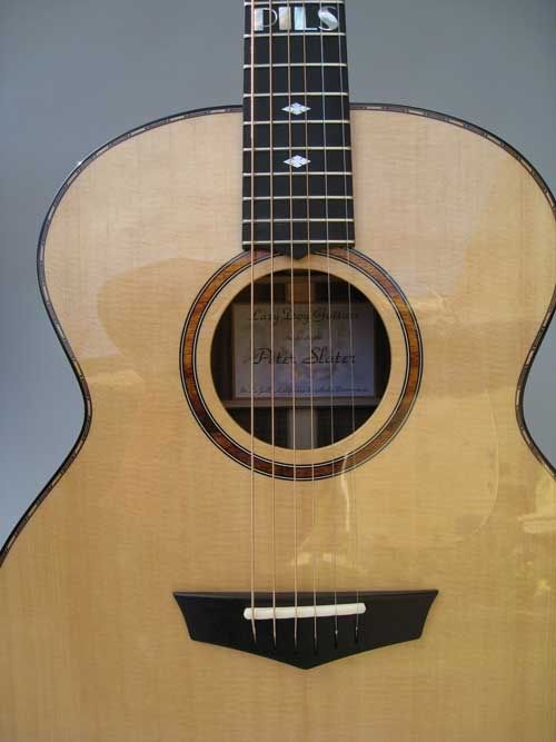

My next endeavor is making a OO nylon crossover. I was thinking of not making the traditional tie block classical bridge.
I do have some pinless bridges for my steel strings and was wondering if it would work just to use one of them.
The idea is to tie a knot at the end of the string and pass it through the pinless slot. The knot would function like the ball end of the string
Do you think this would work???
Below is an example of one of my bridges
PostPosted: Tue May 19, 2009 10:32 am
The idea sounds like it will .. why not try it.
The only downfall I can see is that over time the tension will pull the knot tightly into the hole, possibly forcing the player/owner to have to resort to mechanical means (ouch) to get the darn thing out. the knot likely wont be as large as the ball end of a SS ....

I tried that once, and the unwound treble strings pulled right out of the knot. However, one work-around to that is to heat the end of the treble strings with a match so that it melts and forms a small ball. This should stop the unraveling knot.
Also, keep the hole or slot that the string goes through as small as possible so the single string just clears. Having to make an extra large knot to make up for a loose fitting slot will allow the knot to deform under pressure and slip through.

I think the Ebony would be strong enough, but I'm not seeing where you are going to tie it. The treble, particularly the E, strings are fussy about staying tied, and a ball melted on the end is a good idea. I don't know if the melted ball would be strong enough to keep the string from breaking where the ball is melted on. Usually, you only depend on the ball to stop the knot from slipping. Generally the tie-block on a classical is 6 - 10mm high and 10 - 12 mm thick and bored with 6, 12, or 18 holes depending on preference. It's hard to tell from the angle of the picture of your bridge what would act as the tie-block. However, you could use beads as the ball, and tie a knot, using a figure-eight type knot that shouldn't slip, on the smaller strings. The only ball end nylons I know are the Martin Folk strings. Maybe there are others.

I believe your idea would work. I have not made a classical guitar, but I have owned/played one for many years. You should be able to tie off the string on your bridge.
One thing to mention - I believe your bridge is a little on the large/heavy side for classical.

your idea should work fine.
Either way!
Just remember that you need a good breakover angle on the saddle.
Nylon strings need this more than steel strings.

I think the reason for not using ebony on most nylon strung guitars is not the strength of the wood, but the additional damping that will reduce the output of the nylon strings.

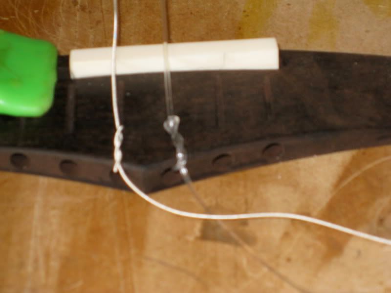

Here is an example of my bridge where I tied some nylon strings through to see how the would sit.
I don't think it looks that bad. I could also use ball end nylons as suggested

Classical guitar bridges usually extend farther across the soundboard. Using that bridge might affect the tone.
I once trimmed the ends off a bridge after gluing it on, and it changed the sound of the guitar a lot. Added an unpleasant clunk.
