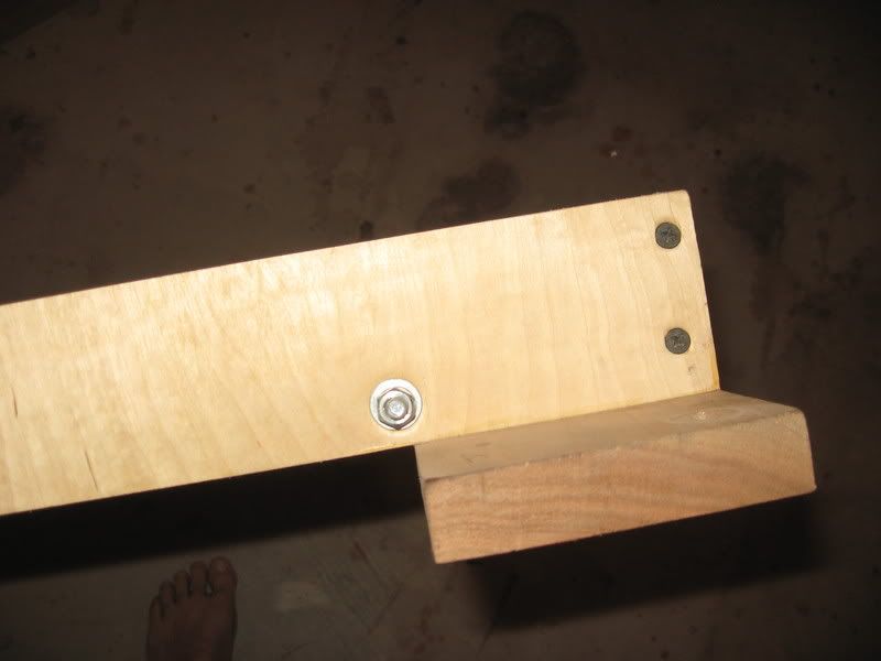

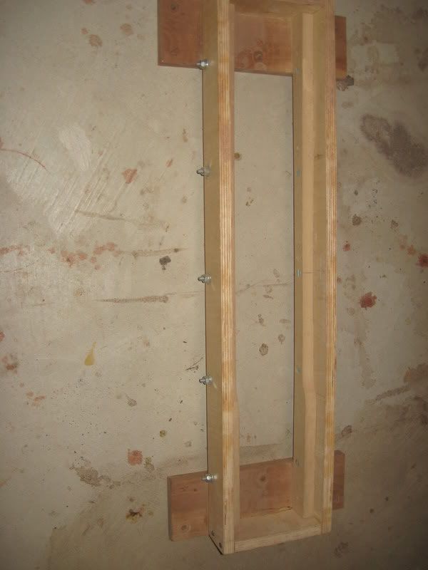

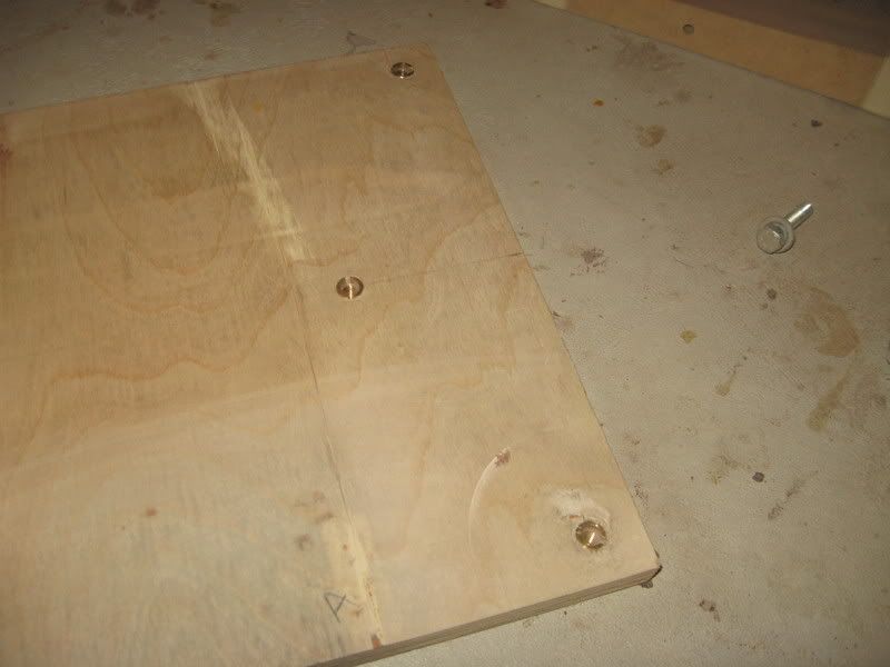

Hi John. Here are some pics of a jig that I built to make my own dishes. I built the base with a 3/8" dowel to center and hold my dish blank, and brass inserts to bolt my carriage to. The carriage is just a frame with base blocks that are thick enough to just clear the top of the MDF blank, and wide enough to accept my router with minimal side to side play. The rails are bolted on to the carriage frame and only have to be profiled to the point where the router can pass the center of the dish. Once the 24" dia. disc is cut and the pilot hole drilled, just bolt the carriage frame to the base and have at it. Be aware that you will have a mountain of MDF dust.
Vince
