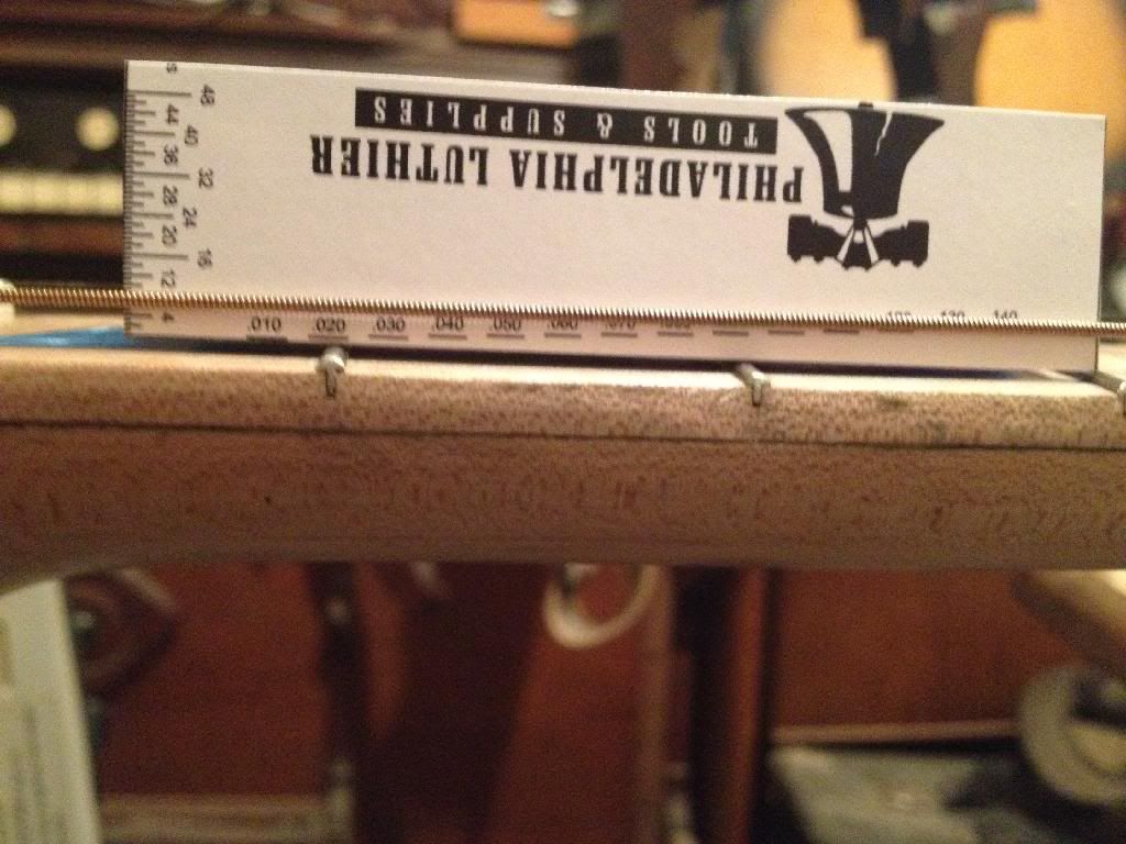

My strings came with a nice lil card that doubled as a gauge on the back. Pretty neat and it allowed me to take better pics. Ok I need to note I'm using old strings because I didn't want to mess up a new set knowing I'm gonna have to remove them a few times. Also I tightened my truss rod to the groan and now the buzz is at just the second fret.

First, take the nut out of the equation. You need to capo the first fret, or fret the string with your finger -- that puts the string just a hair lower than it should be with properly cut slots.
Now, measure action at 12th fret on the bass side and subtract 0.080" (2 mm) -- that's the amount the action needs to come down. To accomplish that, you multiply that amount by 2 and remove that amount from saddle. My guess is you might not have that much saddle above the bridge and might need to reset the neck angle.
Your buzzes sound like high frets. Not sure where you got the fret board, or if the frets have been leveled and dressed.
If your neck angle is OK (see above), you now need to:
1. remove relief with truss rod (i.e., neck dead straight)
2. level and dress frets
3. install and tune strings to pitch
4. re-establish relief by tightening truss rod (fretted 1st and body fret, business card clearance at 6th fret)
5. cut nut slots (fret between 2nd and 3rd, you should have just a hair of clearance over the first -- you don't want a lot, but you will need some!)
6. measure action at 12th, bass and treble sides, and determine amount to reduce
7. remove twice those amounts from bottom of saddle, on each side.
8. intonate saddle
Fret leveling, dressing and set up are essential skills for a builder. If any of the above steps are unfamiliar, go searching the forum and especially the tutorials mentioned earlier by others.

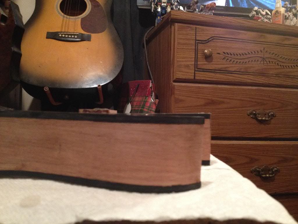

Are you stringing up your guitar without the back on? That's pretty bold.
Might I suggest taking a deep breath and taking a week off from actually building the thing in favor of reading a bit and learning what you are doing right and wrong? I acknowledge your passion and your need to dive into action, but I really think you're not doing yourself a favor in rushing all this work without understanding the basic mechanics. Or you can keep on rushing and have a nice lap steel, perhaps.
Hope you will take this comment positively, as it is meant to be.

Yea I'm pretty bold. I figure it would be easier to start setting up now when I can fix anything on the inside or out with out the limitations of having the back on. And yea I installed the center reinforcement strip really tight before installing the truss. I had to tap the truss a lil to get it in. And no I don't mind taking a break and doing some more reading. Thanks guys.

Evidently you don't know the back of a guitar is an integral part of the instrument... Without it you will never be able to set up the geometry correctly because you are just warping the snot out of the sides and top... I am amazed you have not heard a big snap yet...
Yes... You really do need to read more and learn what you are doing. Without the knowledge of what you are doing you are destined to keep making mistakes. [headinwall]

I really feel like a jack@$$ now. You know how when your having a problem and it stumps everything you try? And when those moments come its best to just step back and think of something else, you know clear your mind. Well I should have done that. That's first lesson learned. Lesson number two was and can anybody see what's wrong with this pic besides the starcaster in the background.
If you look closely to the right of the guitar where the neck joint is, you will see a big'ol Waldo sticking up past the natural level of the soundboard. A major defect that would have cost me another neck trying to fix the problem. The good news is I was able to lower that area and make it level with the rest of the sound board. So yea I'm really sorry.
I called my neck supplier and explained what I was trying to do and the problems I was having and to order a new neck. He said he could put the proper neck angle into the neck as builds it but he was talking about a 2 degree angle, but said he could do at 1 1/2 or 1. Just asking because I have been reading cumpiano on the subject of neck angle and says less that 1 degree, around .06 to .08. And other sites ( when I ask google ) come up with wild neck angles like 18 and even one said around 89 degrees. But these aren't flat top guitars either. Is there an optimal neck angle for a flat top.

That guitar looks to be scrap from the picture. If it were mine I would probably take it apart, salvage the wood you can and burn the rest.
Not having it in hand, it appears you have no radius on the top and the neck angle is the opposite direction it needs to be. A new neck will not fix it and you will be wasting your money. I am not going to go into the reasons I know it is junk because you have to be able to recognize big glaring issues like that before they ever come up.
Don't wast any more of your money and go to the LMI site and use their Kit Wizzard and order a pre serviced kit. Mine came with a DVD that holds your hand all the way through a build. For me it doesn't go into enough of the why part but it will show you the very basics of how to build an acoustic guitar the correct way.
Please, do yourself a favor and build a regular acoustic guitar so you understand how they work. Save the experiments until you can actually build a guitar as it is suppose to be. My guess is that will be 3 or 4 builds. You can sell the ones you build to by the next one and on and on until you completely understand acoustic guitars.
OR....
Scrap the acoustic part all together and go to the Stew Mac and order yourself this:
http://www.stewmac.com/shop/Bodies,_necks,_wood/Electric_guitar_necks/Through-body_Guitar_Neck.html
You can then build a guitar without having to even worry about the geometry other than your string path. Build an an acoustic body the shape of a Valentines day heart if you want because the body will have nothing to do with the geometry.
Just sayin... [uncle]

The final angle on an acoustic neck is whatever is right for the body you made. It might work out to 1 or 2 degrees or something in between. It needs to be calculated and then still refined by flossing the cheeks of the neck to straighten and refine the angle. Robbie's course adresses this a little, but I just ordered John Mayes's DVD on neck setting to try and perfect my technique on this, my 4th guitar build. Bottom line, you may buy a neck with an angle already cut, but if your body geometry isn't complimentary with that, you still won't have the right neck angle. And without the right neck angle you may not have a playable instrument.
LMII has plans for building a mortise and tenon neck cutting jig (I believe you once said your a woodworker so it should be no trouble for you to build) which also sets the neck angle for your individual guitar body. You don't have to cut a mortise and tenon with it, you can just use it and a router to set your angle. I use something similar on mine.
This will save you a lot of money and using it helps visualize the creation of the angle and why it's necessary.

Correct me if I am wrong but if you lay a straight edge on the angle he has the neck block set, it will never point to the bridge. In which case no matter what angle he puts on the neck there will always be that big hump where the neck block is the wrong angle.
Maybe I am not seeing something correctly the geometry is completely wacked.
Again, I am a new builder and have not even completed #1 but I have set probably 60 necks in my time and I think I know guitar geometry.
Anyone?
To me... It looks like he will never get there no matter what angle he has on the neck.
