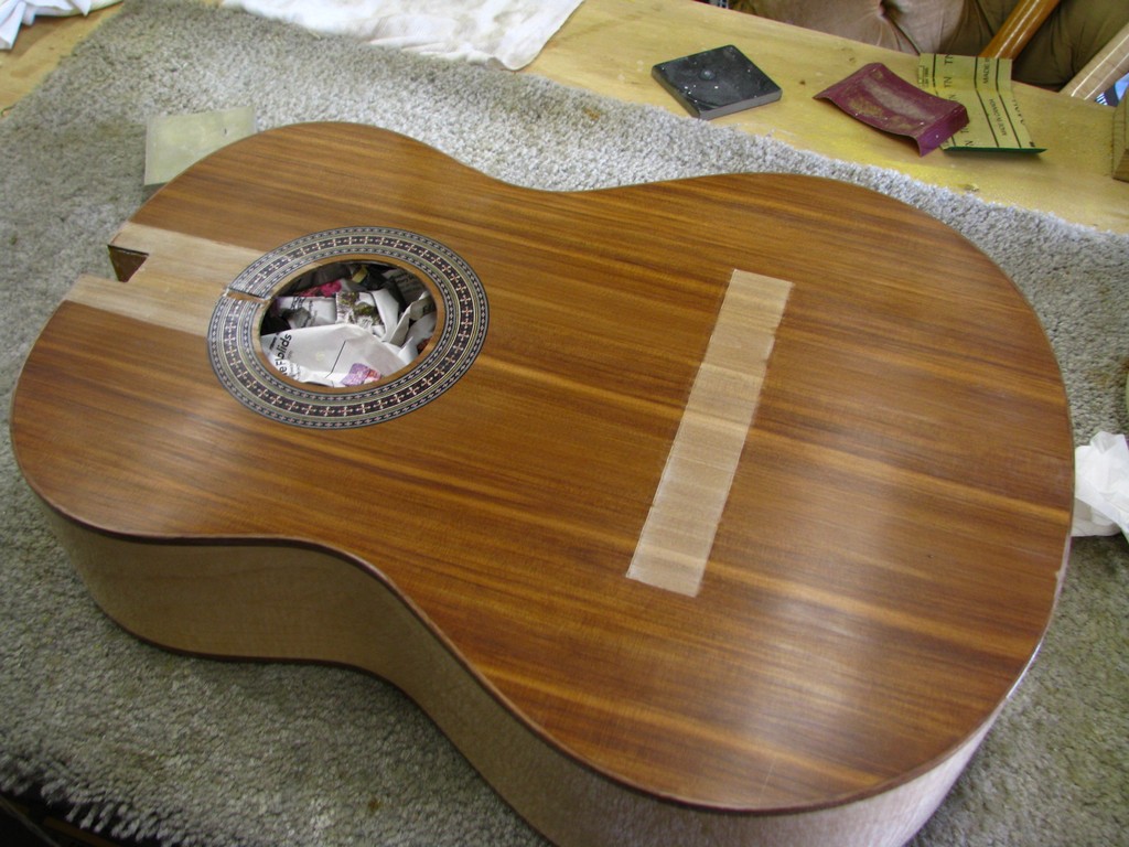

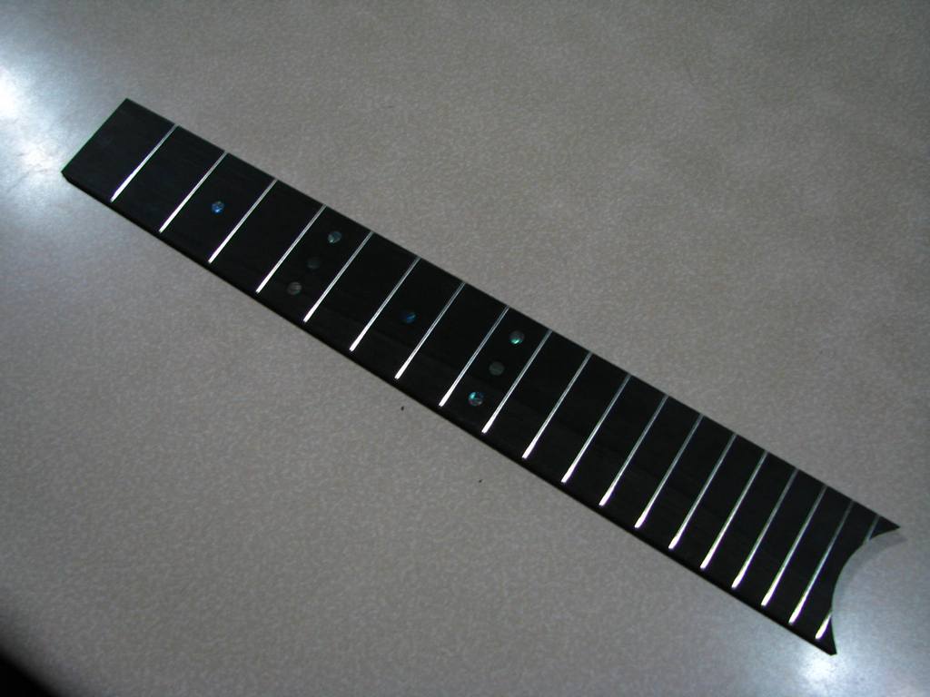

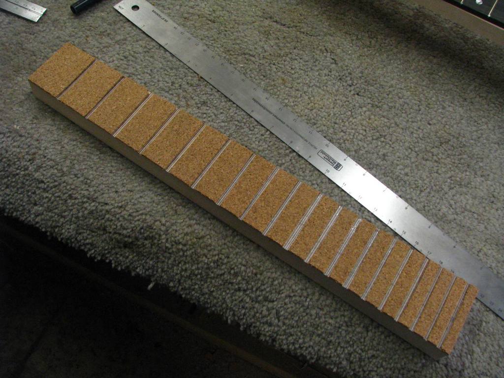

I got a lot done today but kept forgetting to take the camera out to the shop. I got the first coat of lacquer on the body, and got the fingerboard all ready to glue to the neck:
I also made the bridge, but no pics of that yet.

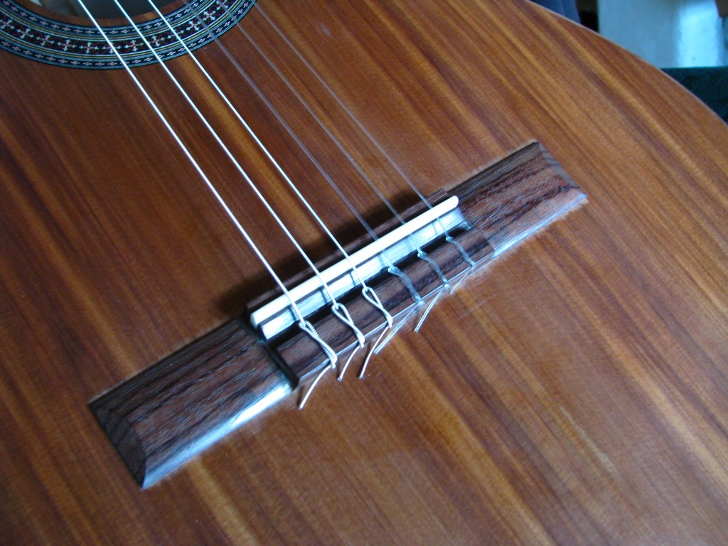

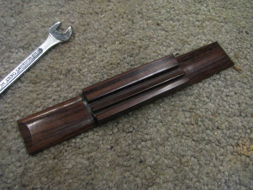

The bridge:
After two coats of lacquer:
Regards,

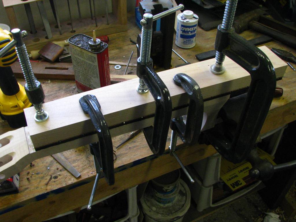

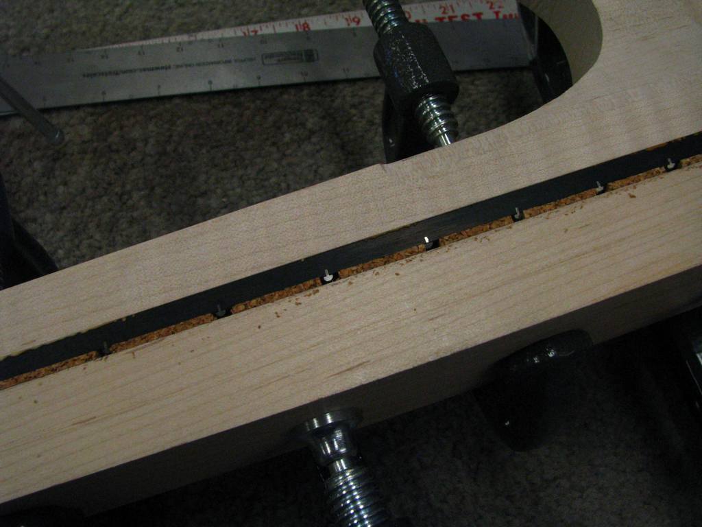

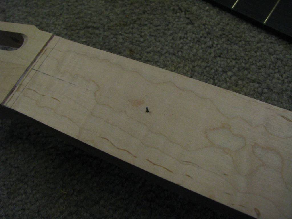

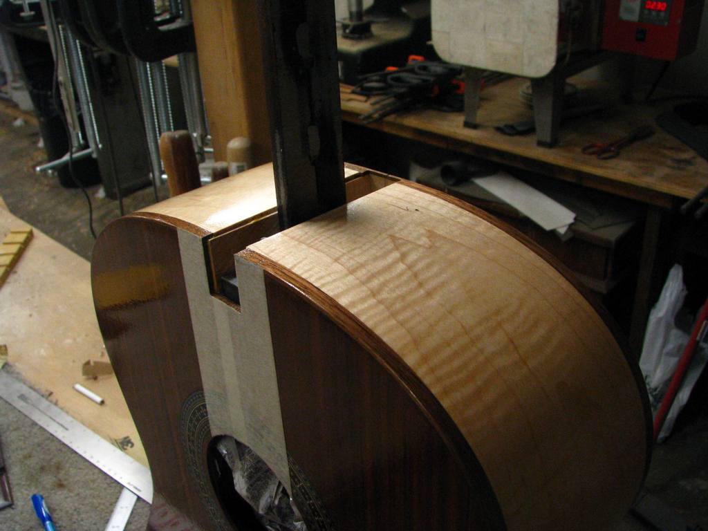

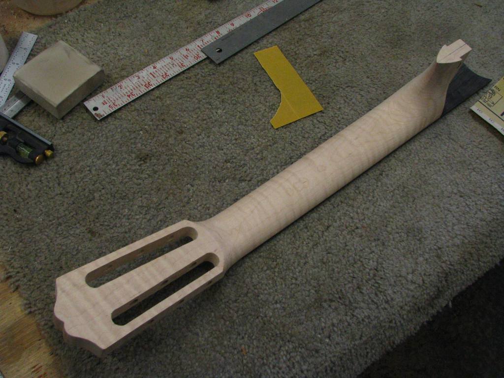

I made this clamping caul...
and used a couple locator pins to keep the fingerboard from shifting around...
while gluing it to the neck:

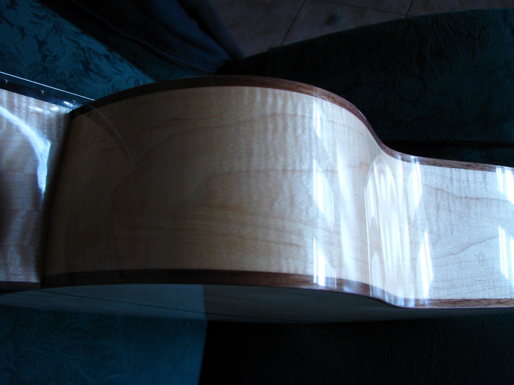

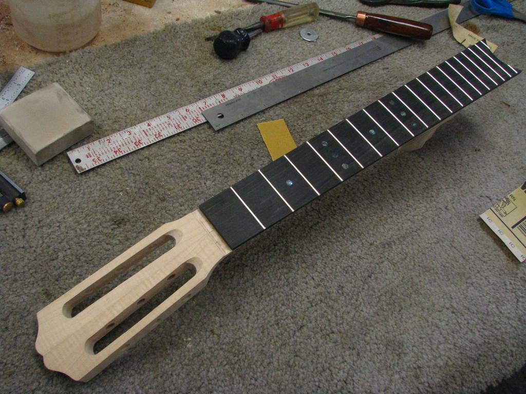

The neck shaped:
and sprayed:

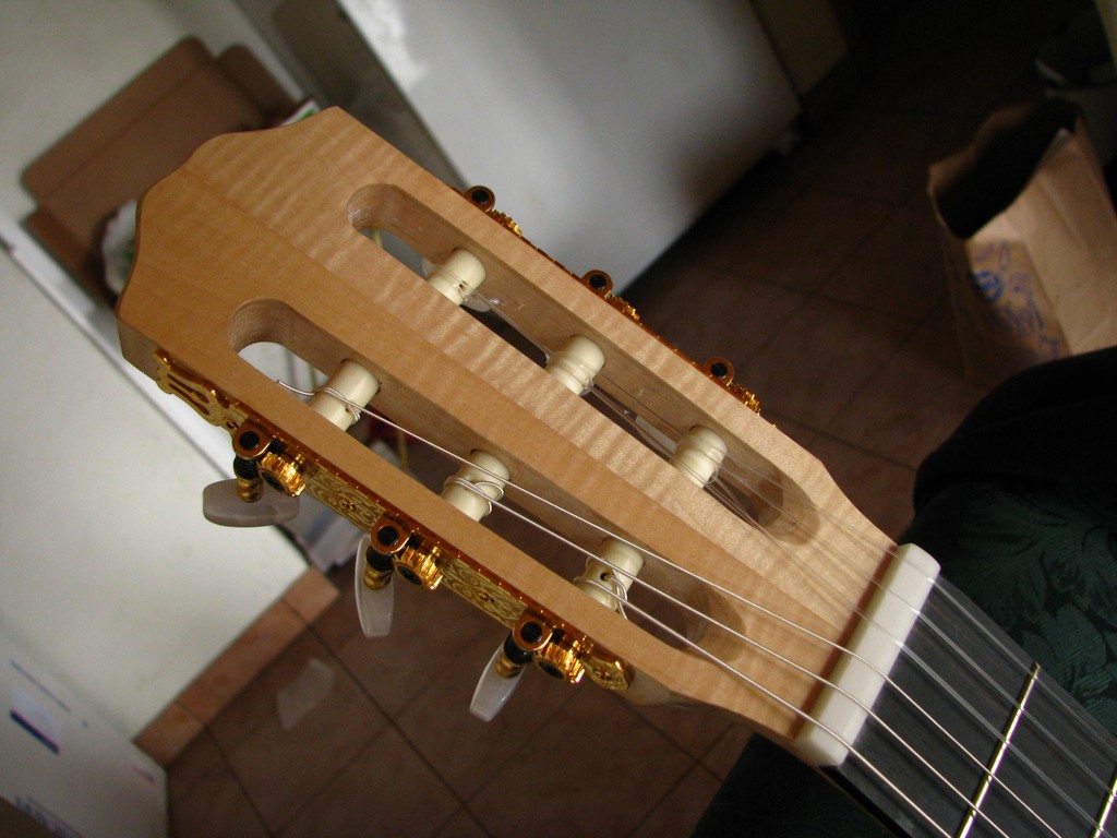

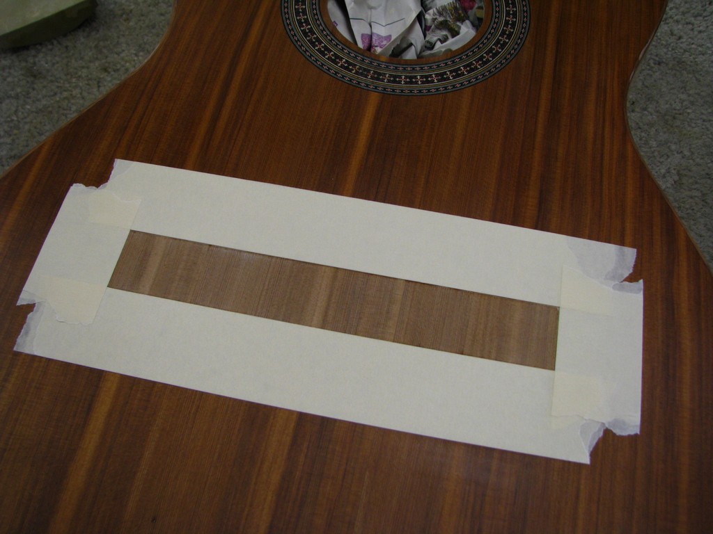

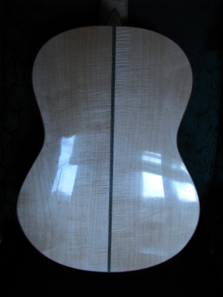

Now that the lacquer has cured for a month, I'm back at it with number 3. Should string it up tomorrow!
Today I sanded it from 400 grit through 2000, and then buffed everything but the top, which I'll do after gluing on the neck/fingerboard and bridge.

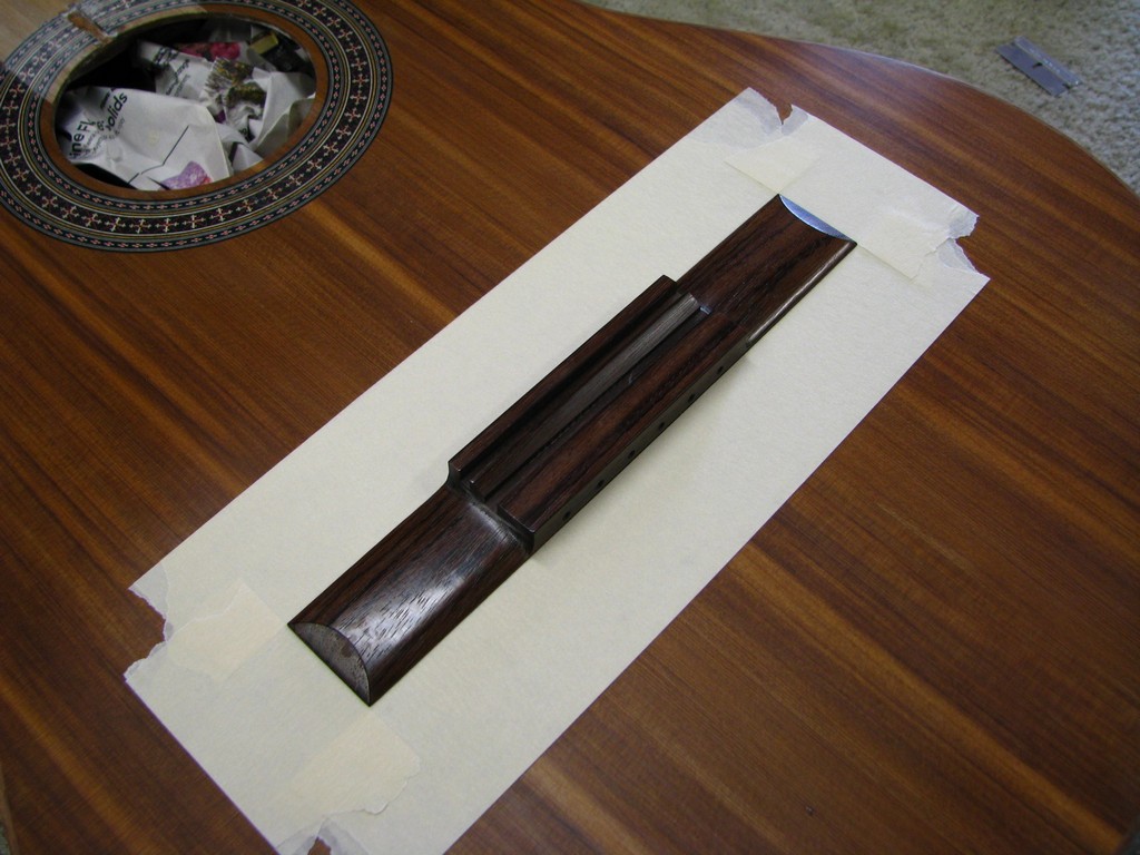

Bordering the bridge area with tape:

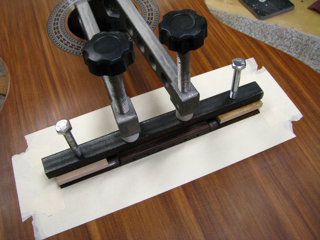

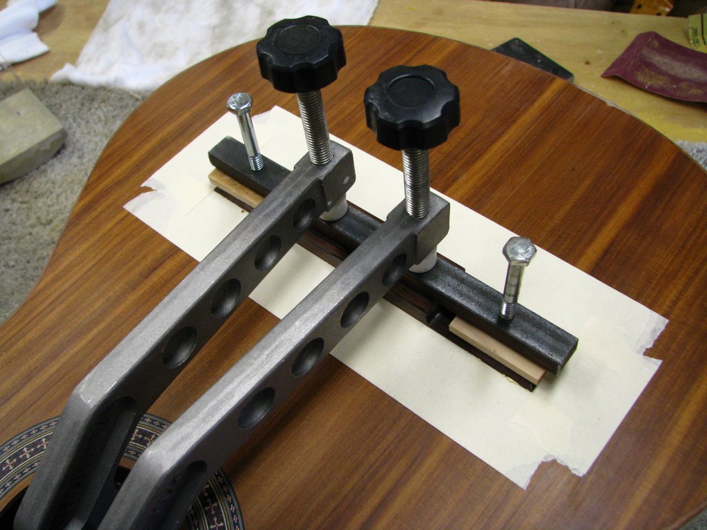

Gluing the bridge on:

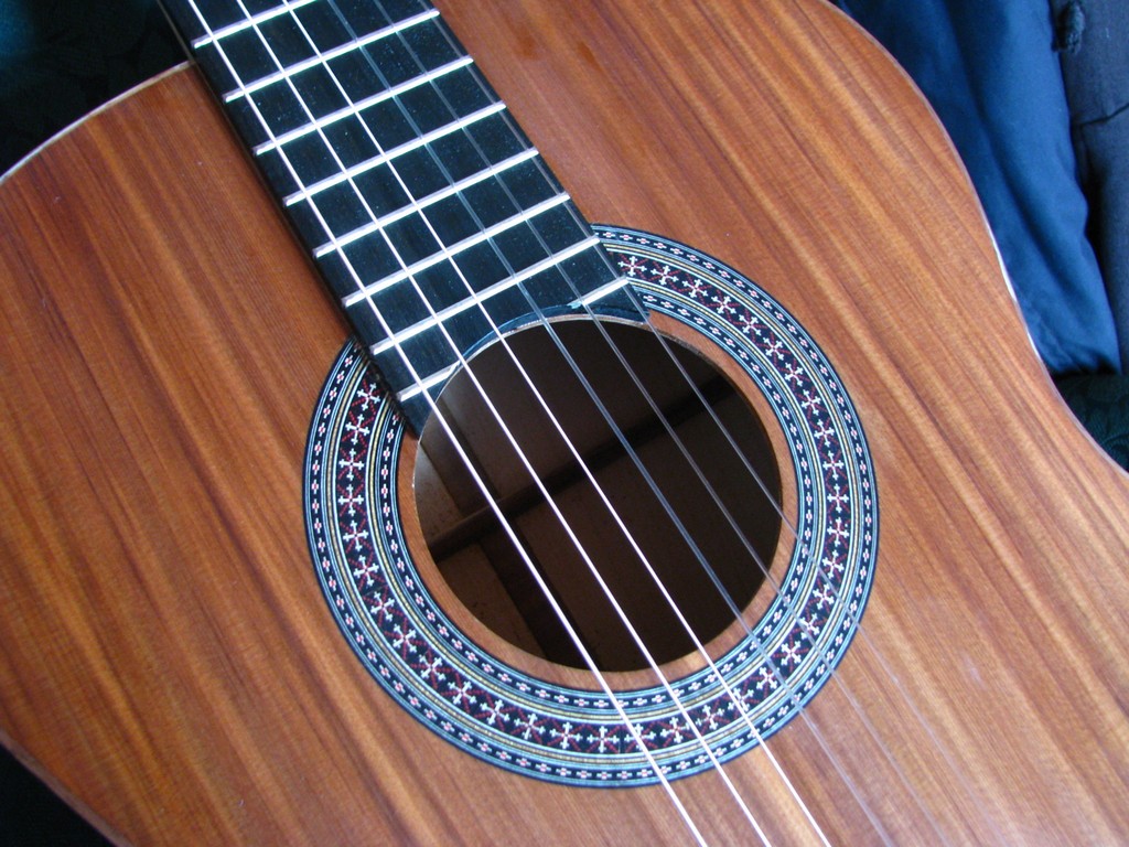

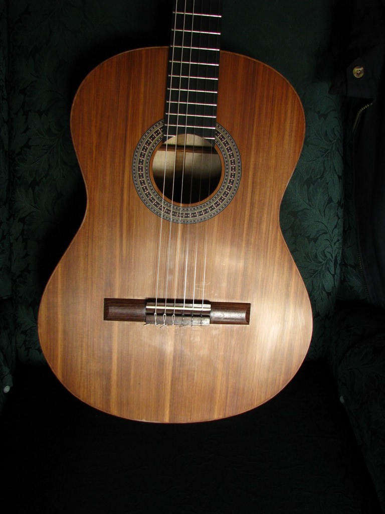

I decided to leave the top with a satin finish.
I haven't played it a lot yet, but so far I'm pretty pleased. It's louder than my first classical. Seems more responsive too.
