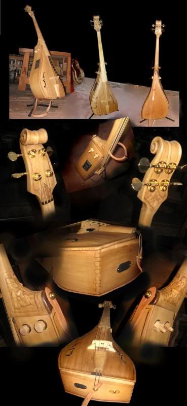

Ok,
the back is on.
the top is done.
me gonna install the transducers next and close here up.
see me in show and tell pic...

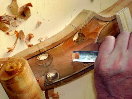

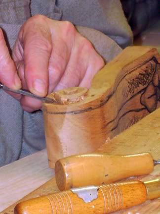

Thanks dudes for your words of kindness.

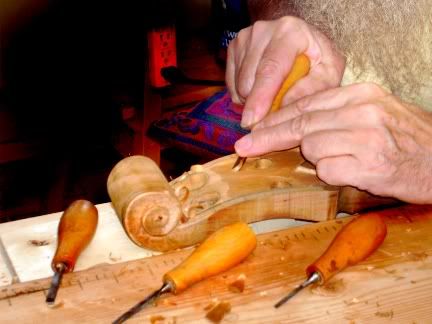

Here be something ...
About carving...
Me always gets comments when ever me post something that was hand tooled or carved and so took it into me head to post this....It is basically the technique being employed in this build...in all me builds for that matter. Here is the secret.
"Make sure you mind is blank just before the blade makes contact"
"What?" is probably your reaction to that statement.
You see dudes, when the breathing stops...the mind stops its monkey babbling. As such you are left with a clear head....if only for a few seconds.
Its simple.
Take in a breath, think the thought of exactly what the blade in you hands is going to do. Breath out, and then as you exhale and have just about released all your breath...do the cut or two or even three cuts...but only while the lungs are empty.
Weather it be a chisel, a knife, a plane, a saw, or even sand paper...like size...it no matter.
Only cut on an exhalation. Never on inhalation.
Inhalation is a charging, movingly into tension.
Exhalation is a calming relaxing gesture.
So....
take your breath, thinking for a moment of the next cut, exhale completely and then execute the cut.
After a while you will start to notice that for a split seconds at the end of each exhalation the mind is blank.
Thats when you squeeze the trigger, make the cut, lay in the brush stroke.
This little meditative technique, if practiced will help tremendously in getting beyond all the monkies running around inside the head, playing havoc with the blade in hand.
At first it will seem that it will take forever "to get the work done"... but the breath is a very calming naturally relaxing rhythm of the body and when followed, will offer up rewarding self confidence in your work, for it will be free of unneeded thoughts and emotions. Or as Leonardo da Vincie said ....anything manifestation by the being is an indication of the inner being.
Breath in, breath out...execute.
Try it, you might likes it.

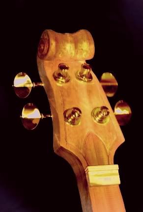

Still needs final clean up
thats all me got done today.

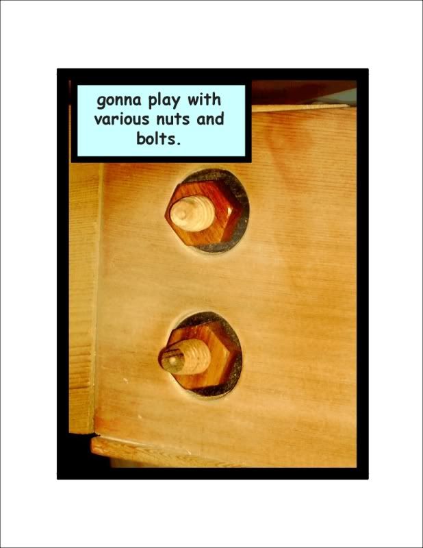

PostPosted: Thu Feb 04, 2010 9:43 pm
Posts: 1982
First name: duh
Last Name: Padma
Thanks for your comments guys....means a lot for me to hear them from you.

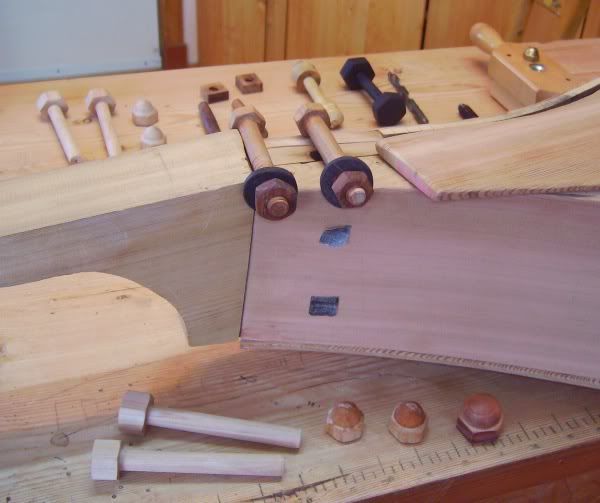

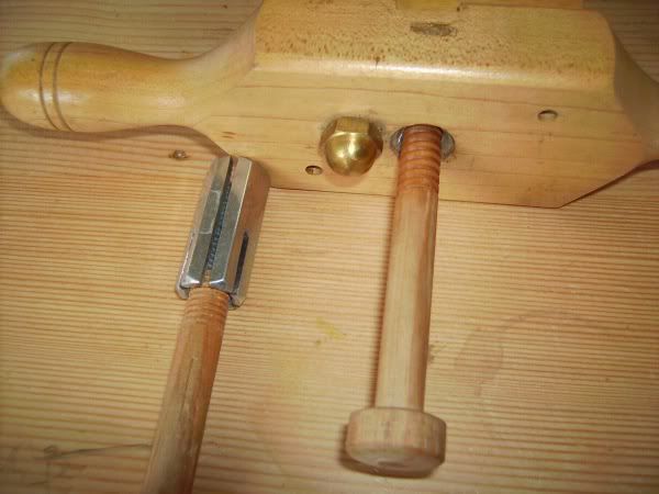

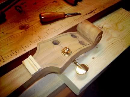

Ok....

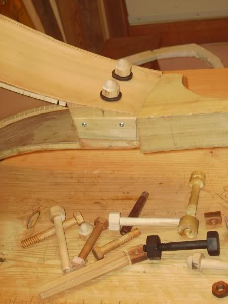

Is nearing bolt on neck time.
Been playing with the bolts and nuts and thread cutters, taps an dies and various woods.
the bits of black tape is where the holes will go.
Narrowed it down to Acorns nuts , these ones are maple
Or Hex nuts out of walnut.
made a tap and die from a bolt and nut...is ok...for a one or two off type of thing.
Boxwood holds real nice threads.
Maple is ok, and so is this really hard African Mahogany I got, cocobolo ~ok, but Box wood is A1. I like the "tigers eye I get from the side grain of the Mahogany on a Acorn...sorry the pic didn't work.
Buddy loanded me his commercial thread cutter and tap its ok too ... but ya still gotta chase the thread with a tri file edge.
Both cutters are good, and much much faster to use, and just as acceptable as the box wood bolt and nut made on metal lathe.
After I get the holes drilled I think I will actually make the final bolts and nuts from box wood and stain them
a light walnut with Black African washers to play of all the red cedar...but that s tomorrow, and I just gotta a flash of brass bolts with Brass acorn nuts....go figure....but not a romantic as wooden nuts and bolts eh!
Tomorrow I make the jig to hold the body and neck on the drill press to drill the holes for me version of the "bolt on neck"

Padma, glad you are back! I've got to say that home made tap and die set pretty much blew my mind. I thought I was pretty good at improvisation in the shop until I saw that. Too cool, man. I love discussions where all the participants inspire each other. Keep the posts coming.
 Post subject: Re: A NO NOthing Build
PostPosted: Sun Feb 07, 2010 10:23 pm
Posts: 1982
First name: duh
Last Name: Padma
Ya dat cut em nuts and bolt up for taps been around long time.
Can even cut up an old C clamp with square threads...they work too!

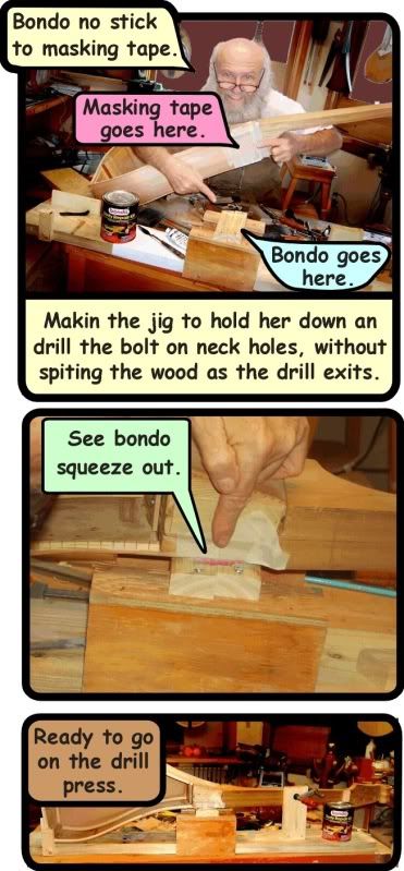

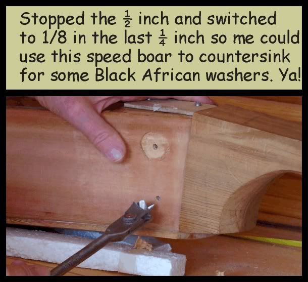

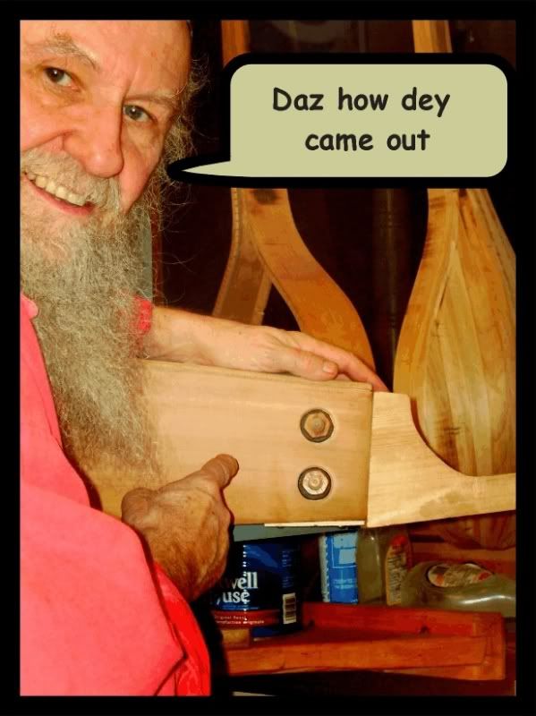

Ok the saga of me NO NOthing build continues with drilling
of the holes for the wooden bolts thats gonna hold on the neck...
yup its a bolt on
laughing6-hehe
laugh dudes and enlighten up a bit!
Not gonna trim the bolts back till after the washers are made.
Datz it, what u see is what they get, and what dey gets ain't gonna get
much betters n what you see...you see! Yes?

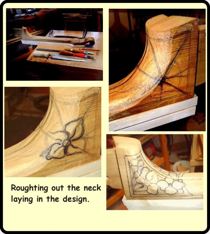

PostPosted: Fri Feb 12, 2010 4:04 am
Posts: 1982
First name: duh
Last Name: Padma

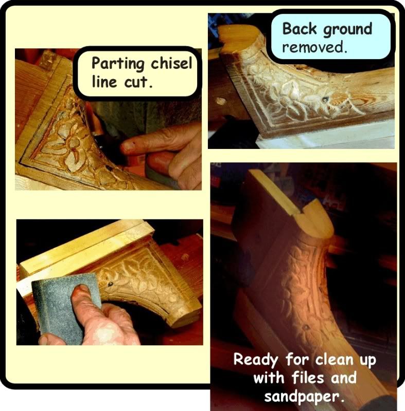

Yes me did carving of the neck and heal to day.
Its cedar and cedar do not take a detailed carve so me did big bold flowers.
blessings
Duh
Padma

Padma your pictorials just keep getting better and better.
Question: When you say clean-up with files and sandpaper how long does this typically take? Is it as big a job as the carving itself to do?

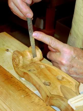

Your work is amazing and I am always interested in seeing and learning more of the details so I hope that you don't mind my questions.
Thanks :)
Well Hesh...the total carve will be about 8 hours....but me no work fast no more and that includes the layout and drawing ....and the jig to hold the neck, perhaps some honing and the occasional sharpening. The heal is mostly end grain and end grain in cedar
is tear out big time ....could have probably done it much faster with a ball bur in a dremel ...but me hates the sound of that banchie screamin away.
Regarding the Padmas Carving Tutorial
...well that was it Dudes...draw out you design, chase it with the parting chisel, use a flat bottom chisel to flatten/remove the back ground . The rest is like carving a brace...just keep removing the wood...and then go at it with some usually starting with 100 grit paper and small files if you got them. Done.
You will run into snags with the grain ... and find out pretty dang fast which way to put the blade to the wood and that all me babbleing and pics are in reality a waste of time...when the chisel hits the wood...you will know by trial and error. Of course if you like. you could always start fiddleing with the elements in the design, using many of the other chisels ...which surprisingly becomes very intuitive and easy after using the parting chisel and a flat chisel....you will immediately know why this chisel will do the cut better than that chisel and it all depend on the wood, its grain, the design and your intuitive feel for the prossess of removing wood with a blade in hand. Quite simply...get a parting chisel and use it first. All the rest will just flow out of your heart.
Best chisels for my likeing
full size ~
Henry Taylor....not cheap...but the best ....see Lee Valley catalouge.
Palm chisels ... Henry Taylor, and the Lee Valley brand but the best palms are the el cheapo sets at the discount stores and flea markets from China. They were selling as low as $10 a set...but word has gotten out and they have started repackaging and charging $ but still a good purchase. Cheap like borscht and good steel in them as well.
Peace and carrots
icu
duh
Padma

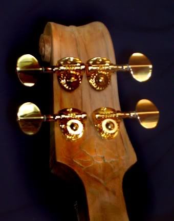

Well dudes...been almost 3 years since me stopped posting to me build threads ~ don't ask why.
However me do gets request from the faithful of how they ended up and well me thinks to me self
(very dangerous thinking is) well, ok...maybe me post a few pics of how she turned out.
If you wanna see the 8 x 10 glossies...ok go here...
http://www.luthierforum.com/index.php?/ ... ntry129381
or here...
https://www.facebook.com/padma.samchuk/ ... 442&type=3
So what me learn from this build? Simple ...me realized me really don't know Jack $hift about looferism...but if you
gots any questions, just ask.
