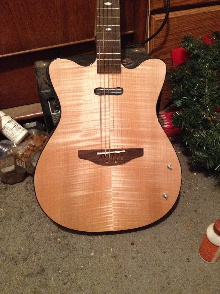

These are shots he posted of his guitar. I said it looked a lot like a Danelectro.
Duhjoker wrote:
Yea,
Here is the one I was talking about.
It is a 1965 Danelectro Convertable. Um... yes I am old enought to remember it...

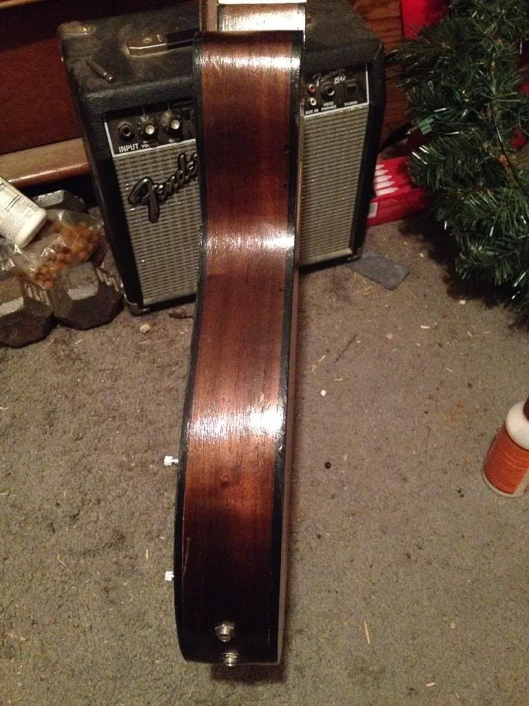

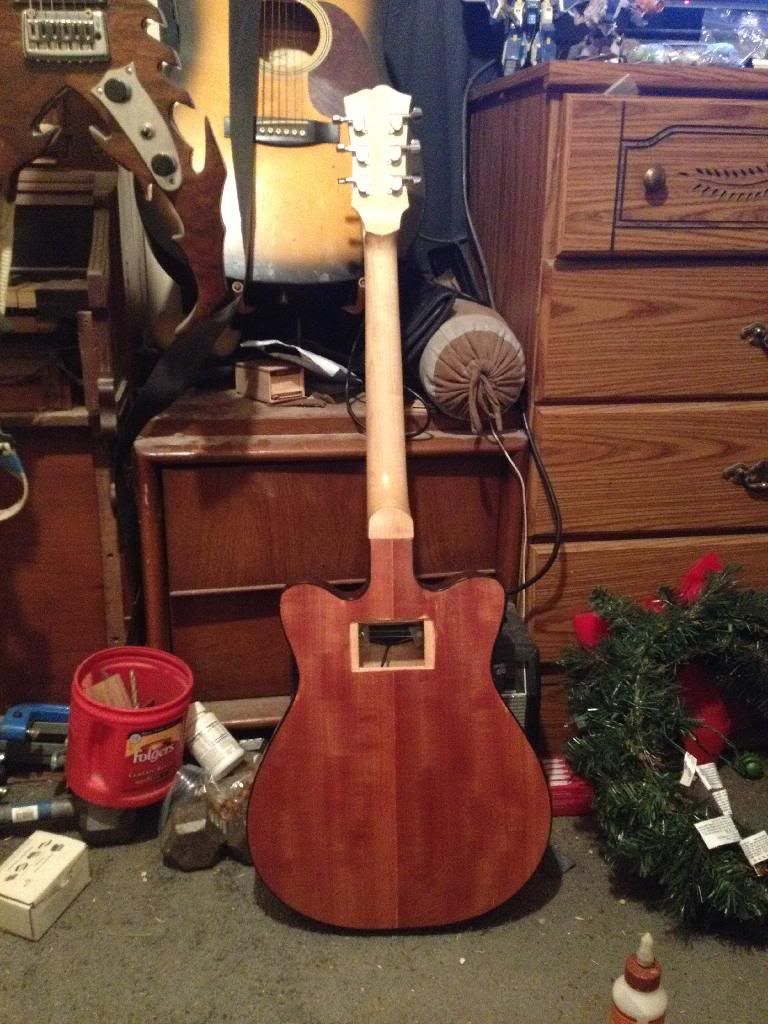

Been playing around with it and I'm severely out of practice and need to spend a couple days rememorizing a few songs and seeing what I need to adjust or fix. So far I can see where my saddle is a hair to high. I think the under saddle transducer might have lifted it up too much. And I think I might drill the dowels out at some point and replace them with bone. I wanted to hear the electric side of it so I went ahead fastened on the hotrail where it couldn't vibrate and wiggle and with a lil height adjustment I was able get it up and running. I've got to say there's a nice balance between the electric and acoustic elements. There's a lil sustain in the sound when in electric mode but it's nothing I can't compensate for in my playing. I like that muddy Drop D sound so it really does balance out. I think by laminating an extra thickness of the maple where I put it helped out there. I might be wrong here but I think it helps dull the vibration that's made by the soundboard. Almost like it was sitting in a solid body. I think I might make another access panel one with a hole, just to have it. But it sounds good acoustically with or with out the panel in place. Any way that's my conclusion so far at day 1. Give me a few days to get my bearings and I'll post a sound byte with some acoustic riffs and some electric riffs to show you what I mean.

Thanks everybody. Yea I have already started buying parts for my second build, trying to figure out which radius or radii that I need on my fret board. Which brings me too what I need help with next. I got over zealous when installing my frets and didn't realize that my fretboard had no radius or really that it needed it. DA me right??!!. Well I know now that's for sure. After playing for a few days and really taking time to listen I'm hearing a few bugs and think that putting a radius on the fretboard will pretty much fix what I'm hearing. So I need to remove all my frets first. What's the best way to pull them out? And what do I do about the ones that are glued in? Or should I just try to remove the fret board itself at this point?

It also helps to make sure it's tune!!!! 'Nuff said!! Still needs fret work but I can do that slowly. Saw stewmac had fret pullers and chip stoppers and then found both for half the price elsewhere. Other than the obvious it plays pretty good. It has a tiny sustain problem in E mode but I was thinking I could laminate a shaved piece of walnut as a pickup cover to hide my mounting hole and to give me more bite to screw my pickup in tighter and the hard wood allows my PU to vibrate less canceling out the sustain.

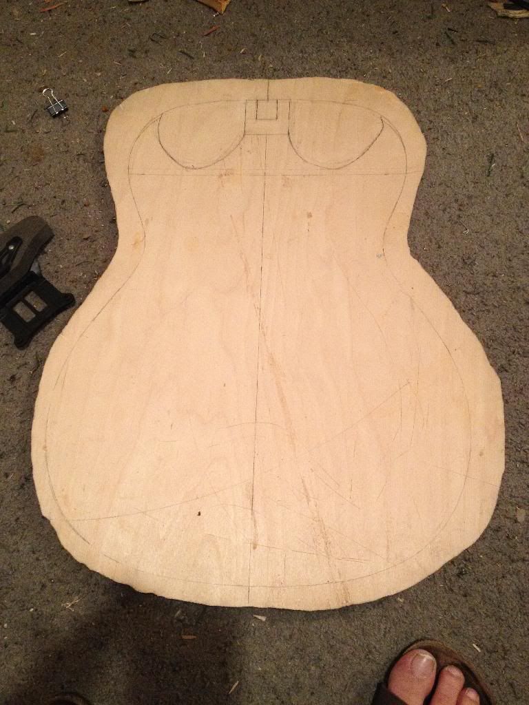

Ordered a fret board today. It's preslotted and pre radiused. The only thing is its super wide measuring:
Nut====1.95---or----1 30/32
Heel===2.45----or----2 14/32
So I'm gonna have to do some fitting to the neck on top of cutting to the right fret. Now I'm pretty sure your supposed to match the neck to the fret board so I called the seller and he said it could be done the other way around. I hope this is right. Please correct me if he's wrong.
Also I've had to make some engineering changes to my next build.
As you can see I'm gonna try to make a florentine cutaway. In order to make the cut outs go deep enough to be able to get to the frets I want I had to move the UTB down a 1/4 inch. I also raised the top of the guitar by 1/8 inch. The neck block looks tiny but I checked my dimensions with my first guitars block dimensions and it's right. I'm gonna make a new inside mold that's shaped like a regular non-cutout guitar tomorrow along with a new bending machine. Just gonna trade all the parts of the old one. And to make the cutouts I'm gonna use A pipe method. Seems easier than making a special mold just to bend those when I can just do it by hand. Any body that's done a florentine please chime in I could use your advice. And thanks to everybody.
