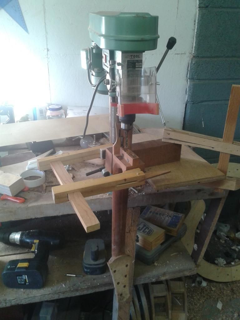

 Post subject: Re: Show me yours...
PostPosted: Sun Jul 06, 2014 7:44 am
Joined: Sun Jun 10, 2012 10:04 am
Posts: 773
First name: Peter
Last Name: Fenske
City: Leeds
State: Yorkshire
Country: Uk

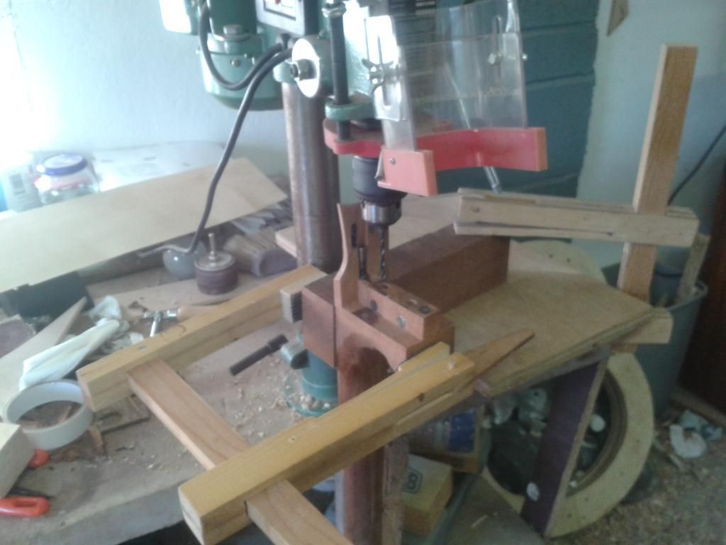

Beth Mayer wrote:
I have a bench top drill press so can't use it to drill the insert holes.
Actually you can with a bit of difficulty... If you mount the drill so the chuck is over the edge of the bench, you can swing the table out of the way and clamp a square section length of wood to it, hanging over the edge. You can then clamp the neck, upright, to that, using a spirit level to level it. Its quite a hassle, but you get better results than using a hand drill.
"I am always doing that which I cannot do, in order that I may learn how to do it."
Pablo Picasso
https://www.facebook.com/FenskeGuitars

PeterF wrote:
Peter, I assume you have a floor model that you use for this. Do you have a picture of your insert-hole-drilling setup?
Nope I have a bench top drill, but removed the base and mounted it to the very edge of the bench with bolts so I'd get more room for stuff like this. Sorry the pictures aren't very clear with all the mess in the background and it is staged - if I was doing it for real, I'd use more and stronger clamps.
Pablo Picasso
These users thanked the author PeterF for the post: Beth Mayer (Sun Jul 06, 2014 4:14 pm)

Beth Mayer wrote:
@Peter - exactly what I wanted to see. Thanks so much for posting that. I might rig mine similarly. I can't tell how you attached the post to your bench without the base on it?
I actually bought it second hand off ebay, and when I got it I saw the base was cracked, so I didn't really have any other options! On the flange at the bottom of the pillar are three holes for mounting it to the base, so I just bolted it down to my bench and its rock solid.
Pablo Picasso
These users thanked the author PeterF for the post: Beth Mayer (Sun Jul 06, 2014 7:11 pm)
