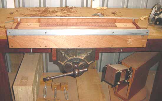

Here is a different take of Rod's and Dave's jig.
Chuck

Rod True wrote:
Well, I did the first 8 guitars with a sanding block. It sucks!!!! 60 grit to hog, 80/100 grit to remove 60 grit sanding marks, 150,180,220,320. The first few grits are going to need a fair amount of human power sanding back and forth, back and forth.....with the remaining needing about 30-40% as much sanding. So after the initial hogging off of material (and during) one needs to stop, brush off the sandpaper of dust, vacuum up the dust off the board and continue, then after one grit is done, you need to load the sanding block with fresh paper of the next higher grit. If stick on sandpaper is used, this is pretty quick but still needs to remove the first grit, clean off the block of any possible glue residue and stick on the next grit etc... everything takes time.
The other factor with sanding in the radius is that it's easy to get the board thinner on one side versus the other (bass to treble side) so a decent sanding jig needs to be made to ensure the sanding block is held parallel to the surface holding the fretboard.
With my jig, I only need to set my router hight which takes about 1 minute (or less) then I'm routing. I can go right to 220 grit backed by my hand after routing... Once my board is thicknessed, tapered, slotted and bound, it only takes me about 3-5 mins to get the jig down, tape the board in place (vacuum would be quicker), set the router bit height and route (4-5 passes is all it takes). So for me at least, this is much easier and quicker and I like it [:Y:]
Hmmmm interesting... Ok I want one now :) But still... I think maybe Fillipo and I ought to be on one team, and you can pick your teammate. The race is on :D
As for the asymmetric sanding using a block... I will attest that this is true. It happened to me on my very first build using a sanding block. But then I figured out that to prevent that you just count your strokes, do 25 in this direction then flip it and do 25 in the other. Works like a charm.
[:Y:]
Everything has pros and cons.
Sanding it in allows you to correct as you go if necessary, though with a little practice that shouldn't be a problem.
Routing the radius requires you to have the jig set perfectly also so that one side doesn't end up thinner than the other, and if t's a little off, it's too late once you start, and also the ends as well, and the platform the fretboard rests on must be perfectly flat, the fretboard must also be attached perfectly parallel to the router path.
