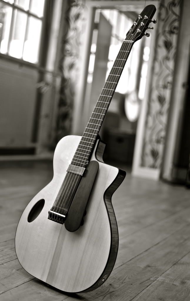

Those of you interested in modern guitar design may be inspired by the latest version of my "long neck" archtops. This one is called "Oscar" after my favourite Jazz player, Oscar Moore.
Questions welcome!

the entire reason acoustic stringed instruments have a "body" is so that the large, lightweight cavity can resonate when the strings vibrate, thus projecting a louder sound.
i would think this concept seems to defeat that goal: the extended heavy neck/fretboard is effectively a damper over the thin sound box. for the same reason, thick finishes, heavy bracing, large pickguards, and massive bridges are shunned.
it looks fine for an amplified instrument but i would think it must be inferior to traditional designed guitars as far as sound and volume goes.
brilliant people have been tinkering with acoustic instrument designs for thousands of years, and there are excellent, solid, practical reasons that most "traditional" acoustic instruments emerged the way they look through the ages
having said all that, nice work, and i definitely enjoy tinkering around as well
Well, I'm pretty familiar with how guitars work. i've made one or two in me time!
Perhaps if you go through the blog posts "The journey of an idea" you'll see how this design came about, and you may begin to understand how it works and the advantages it has for jazz players. Many jazz players when describing what they want from an archtop often describe qualities which are more in line with what flat tops have. And often in line with qualities electric guitars have too. This design in pretty much in line with those wishes. It really works.
Nigel

i just closed the box on my design inspired by this post. Hope it works. Pics later.

Nigel--I'm rewriting this post because I think I went off track the first time. It's great to find someone who enjoys the music of Oscar Moore as much as I do. Thanks for helping to keep his memory alive.

Okay. Here's a peek. Pinless bridge, 25" truss rod (for basses), "backbone" inside, dovetailed onto tail block. I call it the "suspension bridge", because it reminds me of the bay bridge for some reason (with bridge suspended on the top?), or a bow concept, where the neck and string ends are fully connected. It's a bit like your design, but all underneath the top instead. I 'm thinking this guitar will never need a neck reset, among other things, (if it works)... There is in fact no neck joint really to re set... if that makes sense.
Also I think of post tensioned concrete slabs, used on modern bridges, as a possible direction for bracing a top, where string tension itself adds bracing strength somehow. Being a carpenter I am familiar with this idea for reducing the weight and increasing length of unsupported spans of large slabs, and wonder how it could somehow relate to top construction (but this is not yet worked out). I frequently hear of braces acting as I beams, where a thin, tall shape is strongest, and wonder if other construction concepts could be theoretically relevant too.

Mmmm....seen one ore two variations on this theme over the years. So does it work more like my first guitar in the series - that the sound is produced by sympathetic vibration? What's going on under the soundboard?

I think you did a nice Job on your design and execution. The sound is just as you described.
I wish you the best on your future journeys.
