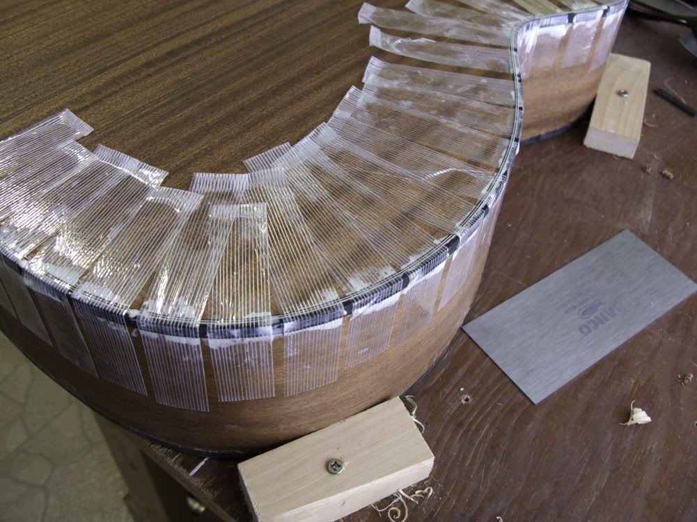

+1 on strapping tape. I cut about 50 pieces before I start & stick them around the edges of a 2'x2' piece of Masonite for easy access in the heat of battle.
PostPosted: Thu Mar 31, 2011 12:34 pm
Joined: Wed Apr 23, 2008 7:16 pm
Posts: 146
I like strapping tape also. I think I'm using LMI's white glue here:
Setting up the tape beforehand made the process a lot smoother for me.
