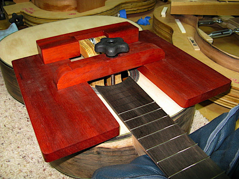

Here's a jig that Jean Larrivee designed back in the '70s ... his was milled from steel, but this one is a "quick-and-nasty" version out of wood that has held its own over my last couple of hundred builds. My buddy Sergei de Jonge calls it the "thinner-downer" and it is used to accurately thin down purfling strips to fit rosette slots, purfling ledges and backstrip routes. From the side view, it is basically just an L-shaped base, with an added moveable block that has an old plane blade embeded in it. You sharpen the plane blade at more of a scraper angle, as it is a scraping action you are wanting. You just slowly adjust the gap between L-base and the moveable block/blade smaller and smaller as you pull your purfling through it ... scraping little shavings off and leaving an accurately thicknessed final product. I've glued a slightly crowned piece of brass opposite my blade so that surface doesn't get worn down. Not exactly rocket science, I know, but easy to make and surprisingly useful!

Nice job on the Sizer, looks good. For those not familliar with these it's actually an old tool concept used by Spanish Rosette Makers. If you have a beveled plane blade or chisel and it is at an 90 to the bed and pull the stip through from the beveled end it will compress the wood some if there isn't a turned burr and pulling it through from the flat end edge which is at a 90 angle it will shave to thickness. Here's my version made from a $25 Stanley plane. It also allows for angling the blade to cut a tapered profile if needed.
viewtopic.php?f=10117&t=23475
