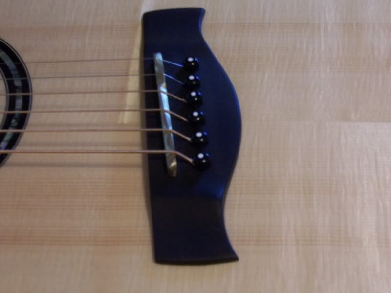

[quote="SimonF"]Who would want to make a saddle out of stainless steel or even brass? -- way to much work and also would be too heavy. quote]
I have not made any saddles out of stainless but, I have used brass. So I guess to answer your question, I would.
"Way to much work?" It doesn't seem to be to me. But then again I am highly skilled at working with the stuff. So I guess it would depend on a persons level of expertivness on what the difficulty factor would be of working with the stuff.
"To heavy?" How did you conclude that? How much heavier are your brass saddles then, say bone? And why did they not work? I discuss with some of my clients the option of using brass parts here or there. I certainly would not want one of my clients, or a prospective client, to get the wrong impression that they should not use brass because it is to heavy. The experience that I have had with brass saddles is, they will work in some situations, but not in others. I will share some of my findings with you if you would like.
But in the mean time, here are some pics.
Brass saddle.

I've used brass alot on nuts and saddles and liked the results as well. But would not think stainless would give the same results as it is too hard of a material and would have a different effect on tone because of that.
