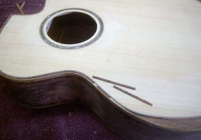

I really like the soundboard purflings on the cedar guitar.... what are they?

Chris aka Sniggly wrote:
Steve,
Really nice guitars and I see something I must ask you about. The purfling on the top...is that a segmented purfling? How did you do that? It looks like a million pieces of EIR that have been staked and then inlaid....I want so bad to do something like that on my next guitar but have no idea where to start.
Chris - No it is not a million pieces. Its more like 50. [:Y:]
Here are a couple of pictures from one I did last night with an armrest. I was the idea here first. I can remember who I'm copying. Terrible manners. (Was it Todd?) I believe he called it radial purfling.
I probably do it wrong, but I just cut out the binding and purfling channels, add the binding and then dry fit the purfling. You should be able to cut the it real close with your band saw.
Oh - the purfling is just cross cut from the extra back cut off. Once everything is fitted I just hit it with CA.
Does that make sense? Can you do it now? Any questions?

Steve thanks a bunch. That is exactly what I needed to know. I can now do it!
Thanks!

peterm wrote:
......I really like the soundboard purflings on the cedar guitar.... what are they?
Peter,
That's EI Rosewood.
