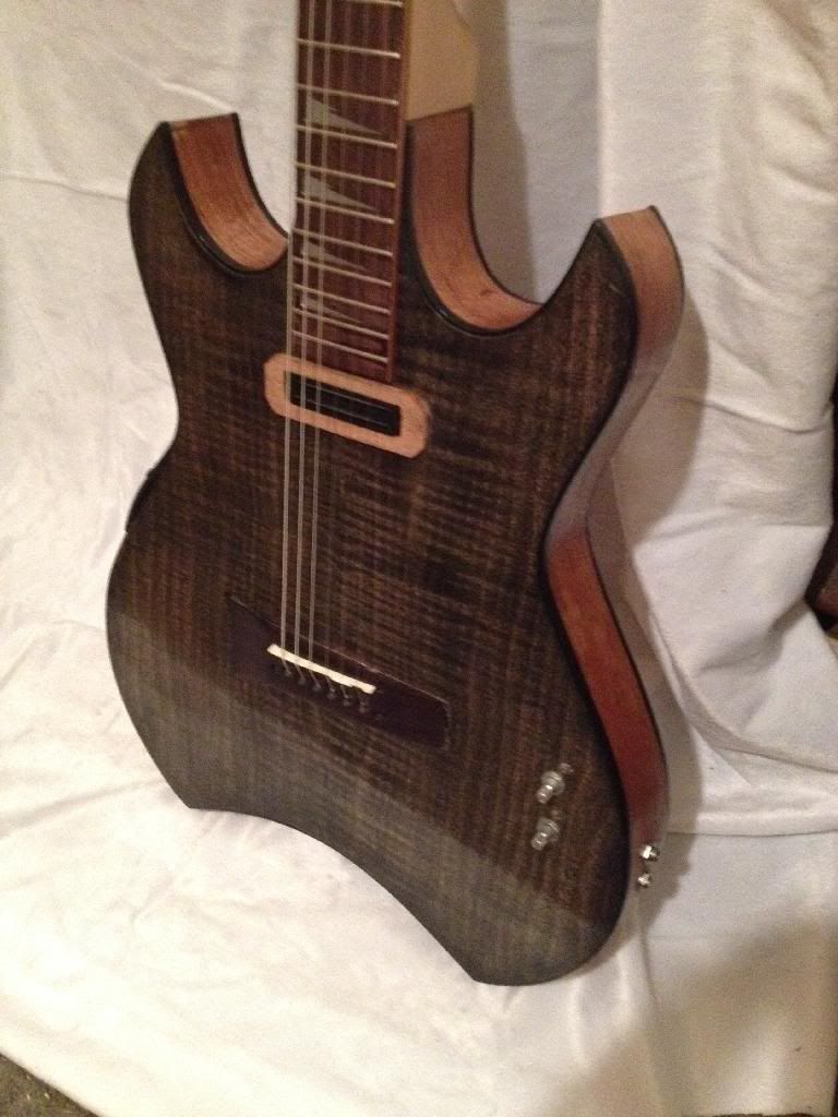

All right so here's where we stand with the triple. My neck came Saturday along with my new fretboard and frets. Spent a day working on the body neck joint area doing a lil build up at the joint and bringing the top down in that area. Then started actually putting the neck together.working backwards was different but not difficult. My neck maker who is awesome by the way hooked me up real good. He made me neck perfectly to my measurements which really helped plus he did go ahead and put an angle on it. So the first thing I did was place the salvaged truss rod kit in it and then placed the CRS. After that I drilled and installed the neck bolts. To get the bolts in the right place I used a drill bit with a bradded tip which I stuck through each hole then placed the neck in the place I wanted and then twisted it making a perfect mark to then drill using the same bit. I don't know what I did wrong this time but cutting the fretboard to size was a major hassle and then I didn't make it wide enough and looked ugly in a couple places so I made some Mahogany binding and fixed that. After that my saddlematic came in handy and I'm so glad I bought it. It made it so much easier to place the fret board in the right place on the neck. After rechecking 5x I glued it on. So after laquering the headstock and neck I placed bolted it up and was a lil disappointed. String height was way to low. Every fret was low and buzzed up to the 8th fret. So I pulled out my work table and placed the guitar face up. And started visually inspecting the problem. Checked my joint area it was flat and even but could see that the neck was tilted a lil too far back. I think Rick used a two degree angle and it needed a one degree angle. To fix this instead of all the crap I tried last time by trying to sand it to the right angle I simply loosend the bolts and stuck a shim in between neck and joint which fixed the angle after tightening. Then stringing it back up I tuned it and now it's the right angle and the strings are high enough to not cause string buzz when played. Whew!!!! But still a lil more work till it's ready to laquer. Gotta make those shims look natural and seal any gap, AGAIN. Oh well at least I know it will play.
Just my opinion and an open obsrvation but the bottom cut out has made no difference in the sound quality, loudness or intonation along with the absent soundhole.

I don't know how I did it but it's done and tuned and sounding GOLDEN!!! I did do a lot of the set up before and while finishing and that helped. But as far as playing and being in tune with no issues. Thank you Lord!!!
So I set the string height easy enough by making shims and setting the nut in top and then stringing a couple strings. I only needed one single high shim. I had worked the saddle down while working on the previous neck. So that's all I needed really was to make sure the neck angle was a go and string it up. I haven't tested any if the electronics yet but I'm sure they'll work. I can definitely say it was worth all the trouble. And sounds awesome.
I'm calling the guitar the Archangel for the body's pair of wings like shape.

Congratulations! Looks amazing. Fun to watch you take it through the process.
These users thanked the author johnparchem for the post: Duhjoker (Fri Feb 28, 2014 12:31 am)
PostPosted: Fri Feb 28, 2014 12:30 am
Joined: Mon Sep 30, 2013 12:51 am
Posts: 280
Location: Where Palm trees grow
First name: Jeremy
Last Name: Wood
City: Galveston
State: Texas
Zip/Postal Code: 77554
I really want to thank everyone for your help. Beth, Nick, James, Rusrob, and everyone whose name I can't think of right now. Thank you. You were all instrumental in the completion of this project. And thanks to the OLF in general for this site.
I do hope this project will inspire a lil free'er thinking in the design and engineering aspects of the build.
In order to make an apple pie from scratch you must first invent the universe.
- Carl Sagan
