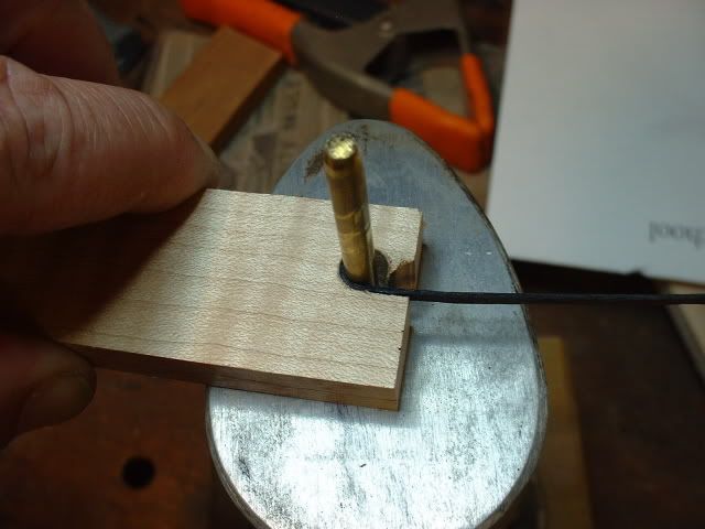

Make sure you have no run out in the binding material and then make yourself a backer jig like this and you should be fine.
Not as easy as plastic but worth the extra hassle IMHO.
