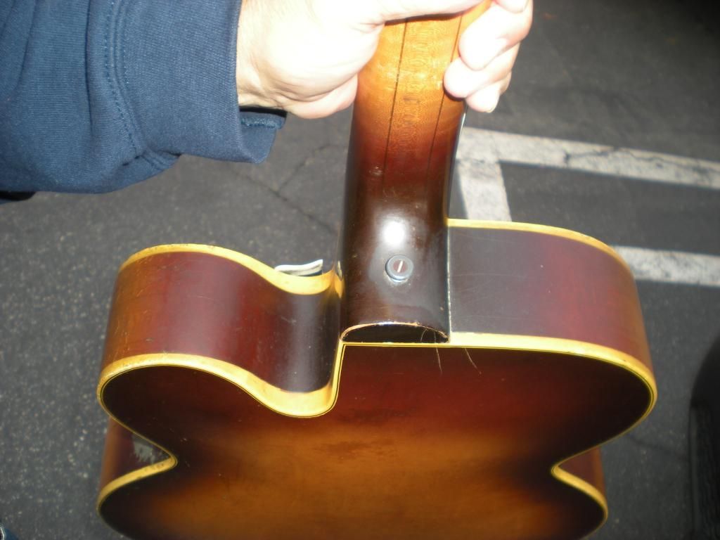

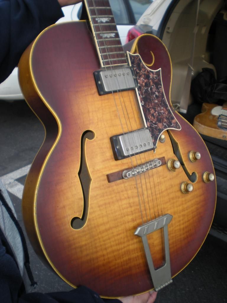

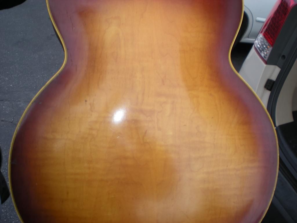

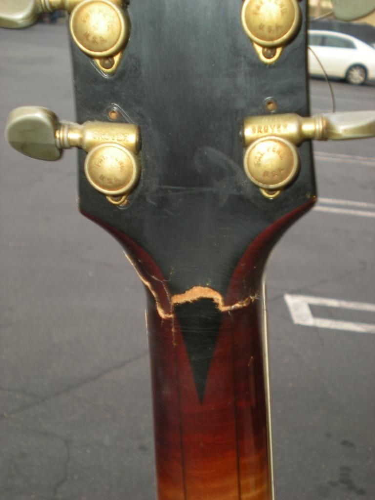

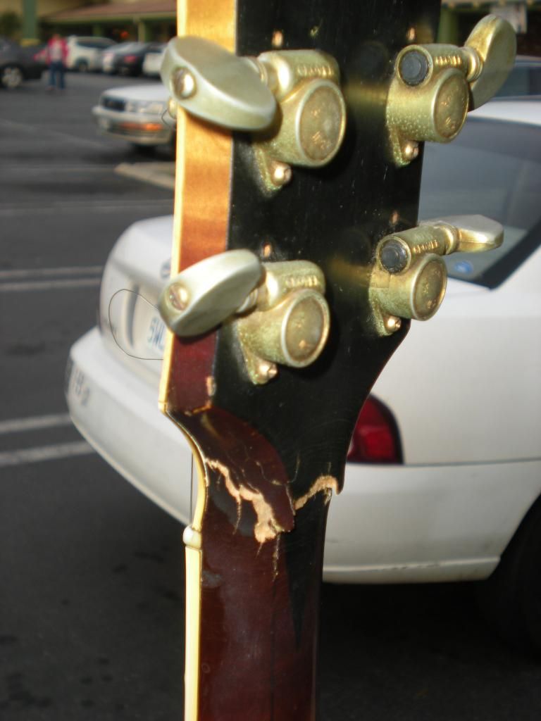

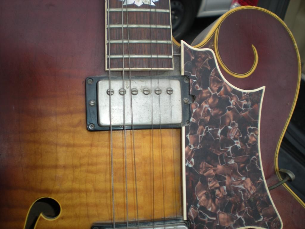

The Gibson Tal Farlow will most likely be coming back to me in a few days with a repaired neck. I wanted to ask: If I want to make the finish on this guitar shine for photographs, what might I put on it, if anything? After my experience with the Telecaster, I wanted to get advice on this before doing anything at all. A buddy of mine told me that an old finish like this could potentially flake off in places, reducing the value of the instrument. I know that some people use either mineral oil or linseed oil, and apply it very lightly.
Should I just leave it alone and not touch the finish? Is there anything I could use that would be very gentle and safe in this instance?
I'm embedding a few photos below. Please feel free to take a close at the finish and share your opinion. I appreciate it.

Hi ya Scott: I would start with just some spritzed distilled water and very soft rags to get some of the surface dirt off.
After that you can safely use Meguiar's number 2 "fine-cut cleaner" and/or Meguiar's number 9 "Swirl remover." The swirl remover will take a bit longer being less agressive and if you are OK with this it's all you need. Again use uber soft rags so as not to scratch anything.
Both Meguiar's products are widely available at auto-parts stores.
