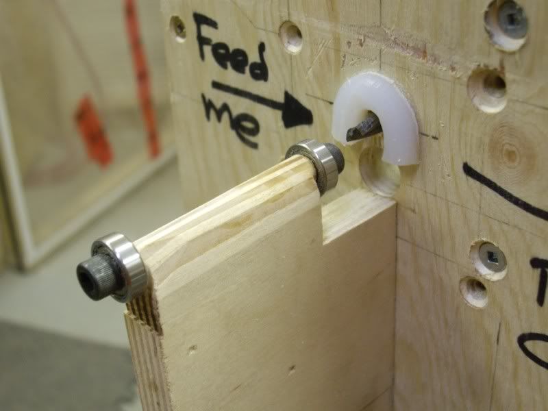

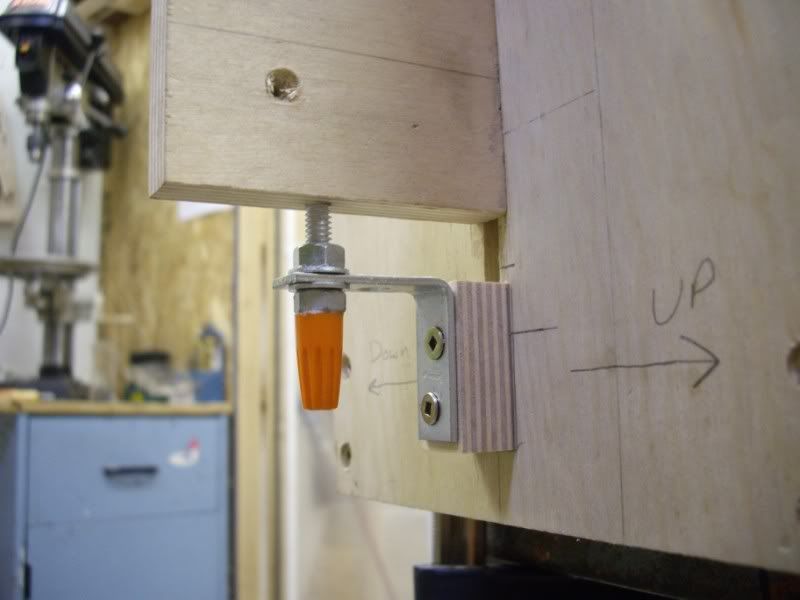

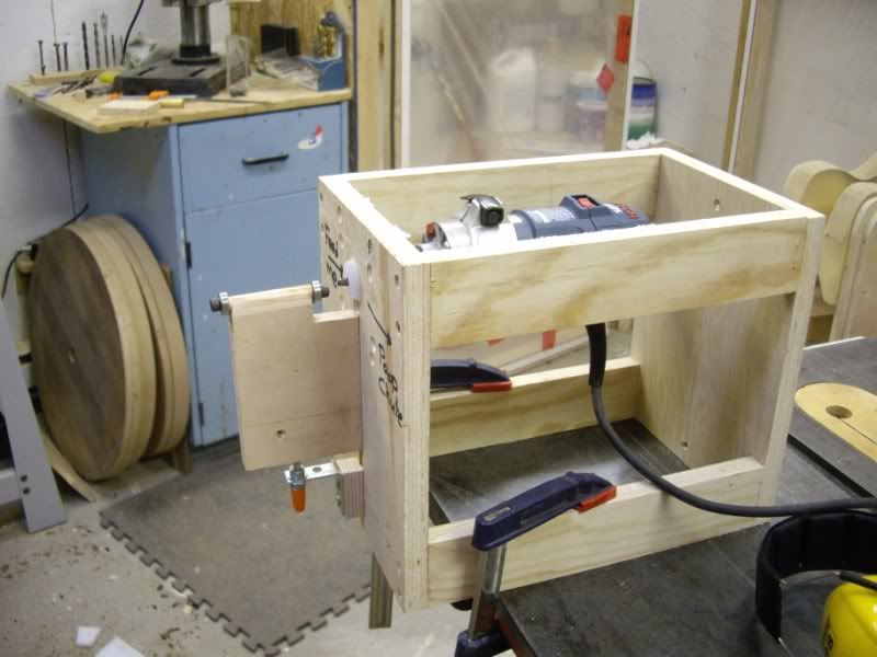

Here's my binding jig.
It works on the same principle as other hand held types but you move the guitar body instead of the tool. Also works the same as those that Larrivee and Taylor both use. Take a look at the Taylor factory Friday video, binding part 1 as a sort of 'tutorial' on how it's used.
Here are some more pictures on it's construction. It cost very little, works very well. Just my style :)
The block with the bearings has two threaded rods in the end (going through the main plate) which lock the block to the main plate with some three pronged knobs. The main plate has a slot in it.
And the fine adjust for binding/purfling thickness. I move the bit in and out for the depth of cut.
