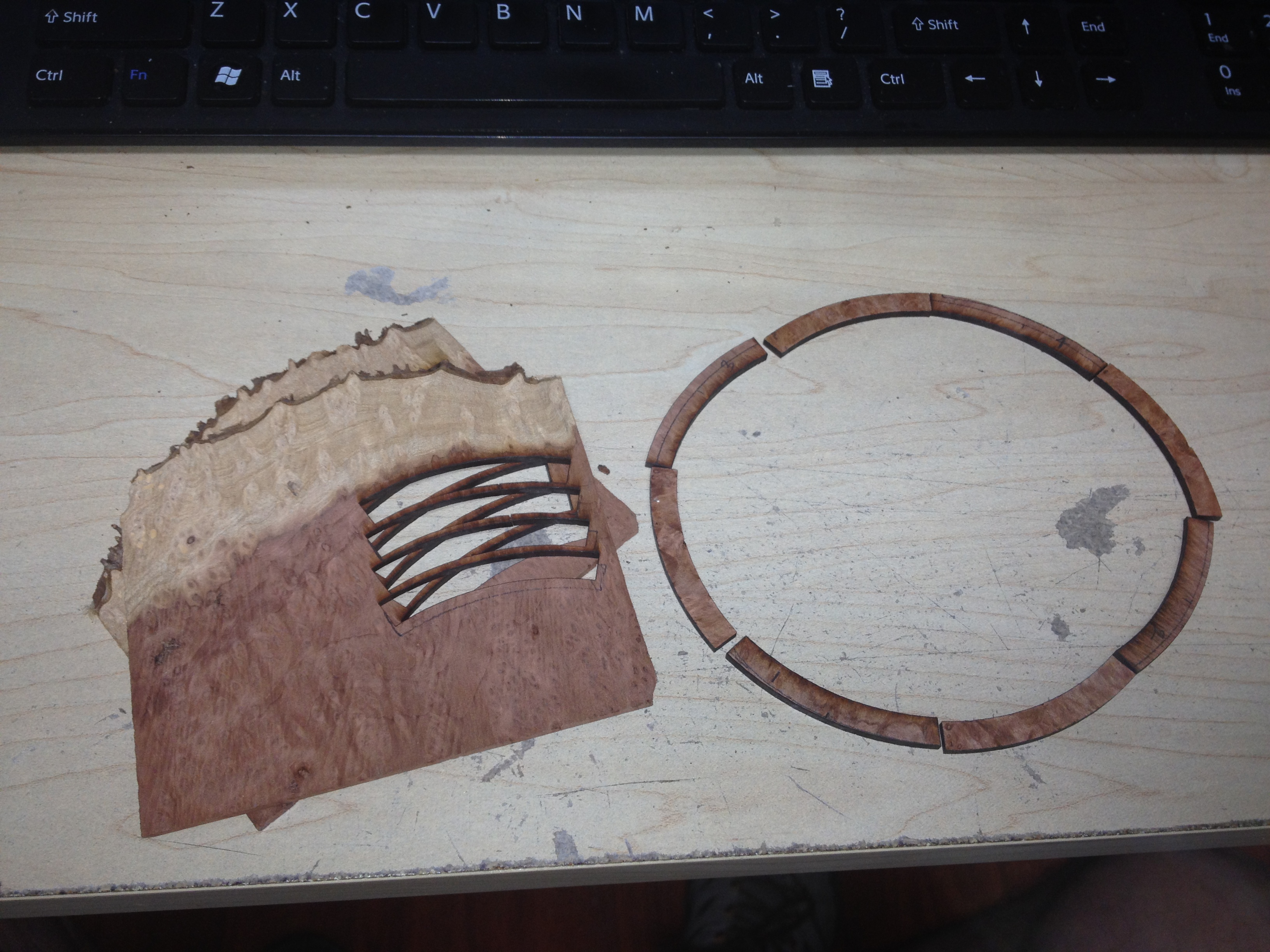

Next I took on the rosette. At the recent American Association of Woodturners symposium in San Jose, I got chatting with a vendor who was selling huge spalted and burl turning blocks but who had a bunch of small offcuts that he didn't know what to do with. I persuaded him that they might be perfect for making my rosettes, so he gave me a slack handful of them gratis and told me to try them out and send him a picture or two when I used them. Well, I picked out a nice lump of redwood burl from his generous gift pile - here it is after I sliced it up on my small bandsaw:
I laser-cut 8 segments out of a couple of slices of it to form a nice 1/4" wide wood rosette ring. Here's the segments:

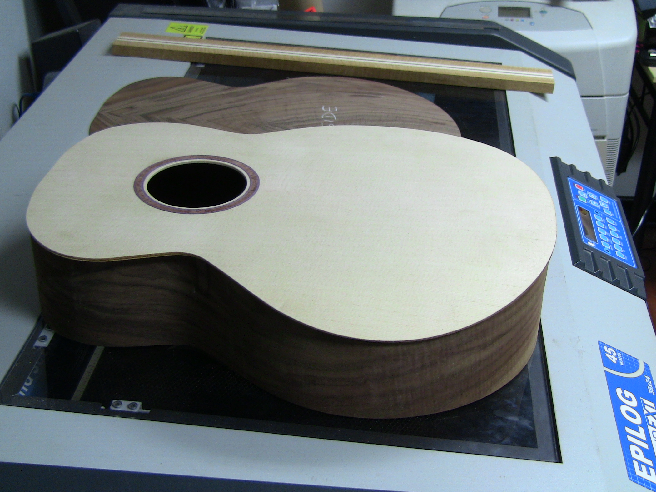

So, here's the purf bending and fitting into channels around the redwood burl rosette video:
After what you see in the video above, I cut the soundboard hole out and rounded over the edges a bit:
What do you think? Not too shabby for such low cost IMO.

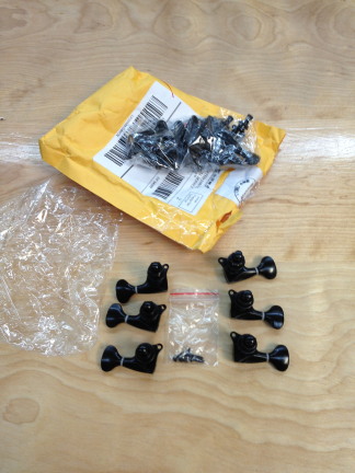

My "Gotoh Style" tuners arrived from Hong Kong....they're not bad considering the price ($9.99 a set!):

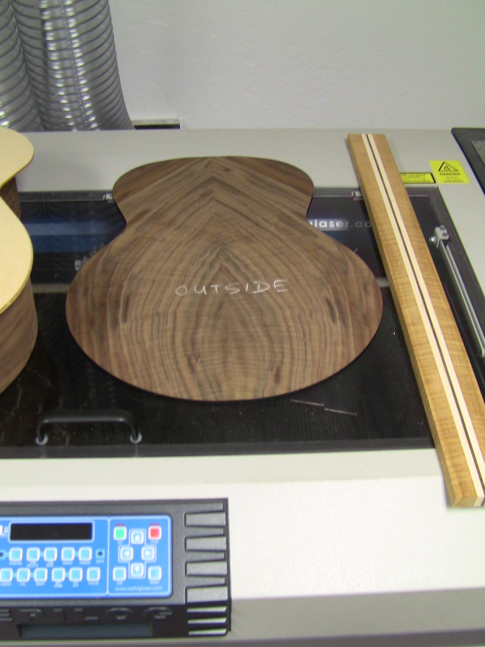

I needed to prepare the back and joint it. There were some nasty knotty inclusions in the back pieces, so I decided to re-cut the joint line to exclude the nasty bits:
Checked with the OLF-SJ template (that I drew up and laser-cut) to see if it would still fit.....it did, just:
Then glued the two bookmatched pieces together and cut the oversized SJ shape out using my laser and wide-belt sanded the back to 0.091":
I love the claro walnut figure in the back and sides - it's got color and flame! (BTW, the neck blank shown in the picture above is NOT for this build)

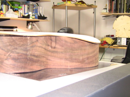

Pstttttt Dave , there is a big low spot in the lower bout of your guitar and the tops all kattiwonkus ..... thought I would mention it before someone else see's it . :D

Shoot, so it is Wud! I'd better glue it down to something solid (like a side) before it droops any more..... :D
Braces?! It don't need no steekin' braces!! Well, it does on the back, but none planned for the soundboard Steve.
That's how I get around the problem of gluing them in [:Y:]
The "triple top" is very stiff and stable, and acts more like a drum skin that a standardly-braced soundboard (probably end up sounding like a banjo wow7-eyes )

I left them very high around the smooth bevel area, since the droopy soundboard will meet the side at quite an angle, so more meat is needed on the inner edge of the linings. Comprende?
That's it for today. I'll glue in the back set of A4 kerfed linings later tonight before I go home, then it's more dish sanding and finesse sanding by hand for the smooth bevel area, and then it's on to the carbon fiber buttress rods (between the neck block and the soon to be added waist blocks), the anti-split side vertical pieces, then on to closing the box!

Here's some of what I did today.
Sawed a piece of bracing material off a piece from the huge pile of the stuff I have....I'm guessing the 4 braces for the back came to about $2 total (I get a whole chunk of split bracewood for $5 when I buy soundboard material, and that's enough for 2 to 3 guitars).
Milled the bracewood into 4 pieces 0.25" thick, then set them aside ready to cut out on the laser:
Then used the top of the center soundboard piece to form the internal back strip and glued it up in the go-bar deck:
While the back strip was drying, I lasered out the 4 back braces. Laser cutting them allows me to cut some weight reduction holes in them, fully shape the top of them, and put a 20' radius on the bottom of them. They only require a light sanding on the bottom before gluing onto the back in the go bar deck. I have some video of the brace laser cutting, but it will have to wait until tomorrow, sorry!
While the braces were drying, I made a small laser-engraved and laser cut label to go on the inside-back of the guitar. The wood for this came from LMI's annual sale where they sell stacks of stuff for $5 a pound. The label weighs just under 0.5oz so let's make that (0.5/(5*16))*$5 = $0.03125, so rounding up, let's say 4 cents :D
Here's the label being glued in:
And here's the finished back:
The carbon fiber buttress rods and the anti-split side vertical pieces will be fitted first tomorrow, then the back will be fitted and glued to the sides, yay!
