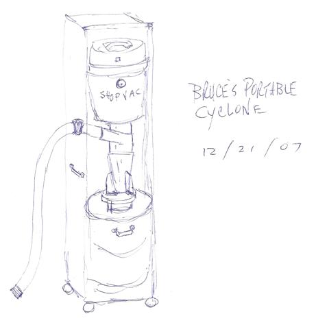

Ed, had to think about it for a few minutes, but he gave my drawing the thumbs up. Tim, I don't have a place to put one more thing in my shop without adding on. But with the results you've shown, I just had to have one of these babies for starters. I've wanted to redo my dust redistributor for a while now. Check out my drawing. The SHOP VACs are on sale 10% in the before Christmas sale, paid for half the shipping on the Mini ClearVueClyclones.com Cyclone.
PostPosted: Fri Dec 21, 2007 12:26 pm
Note: In my above rendering, this eliminates the hose connecting the ShopVac to the ClearVueCyclone. Going vertical and eliminating the extra hose simplifies it a bit, of course I still have to build the cart.
