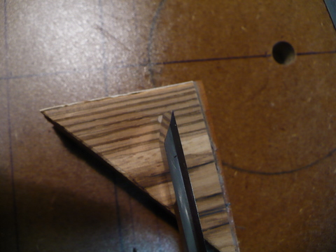

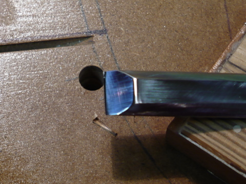

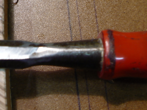

Just for fun, I took an old chisel that had been used for prying nails, was ground ar the wrong angle, and had been rusted and cleaned a little.  I should have taken a before picture, but the whole thing looked like the shank up by the handle.
I did spend about 10 minutes on it, but it is now scary sharp.

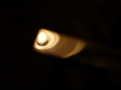

This is the back - the camera focused on the light reflection.

Waddy that is pretty impressive!
