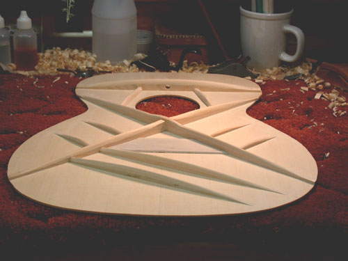

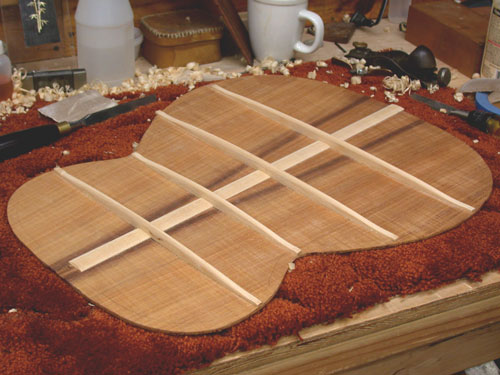

Made some progress this weekend on my nephew's koa 000.
Lutz and koa came from BobC.
Next weekend, close 'er up!

Pat-
It's looking good.
It's also great to see a bench with some tools that don't look like they were made yesterday! (Still a bit too neat, but there's hope for you yet!)

Pat, Yes! Looking real good!
Very neat work on the braces!
Curious though, why the hole in the brace?
Could it be access to the truss rod nut?
Robert
PostPosted: Mon Apr 16, 2007 12:22 am
Yes, that's it, Robert.

Very graceful parabolic braces. Beautiful to look at.

Thanks for the kind words, all. This time (#3, with #2 still in the wings), I've matched the resonant pitch of the top and back per Alan Carruth's generous posts here and elsewhere. If all goes well, the top will drop a half-step or so with the bridge on and I'll get smooth response with the back adding to the top's output. Here's hoping!

whats parabolic bracing?
PostPosted: Mon Apr 16, 2007 12:34 pm
Jeremy,
Parabolic describes (sometimes approximately) the shape of the braces, in their profile along their length and also in cross-section.
This search of the archives should give you some background.
