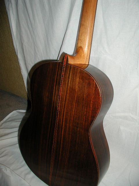

I think it would be more than appropriate to use FP on your first. Assuming you are keeping it for yourself, why not use that as your practice finishing guitar, so that you aren't "learning" on some later guitar going to someone else?
Here's a peek at my first classical, first FP (now that the upload works again )
The finish job needs more final polishing, and I wish it hadn't been on a guitar going to someone else.
