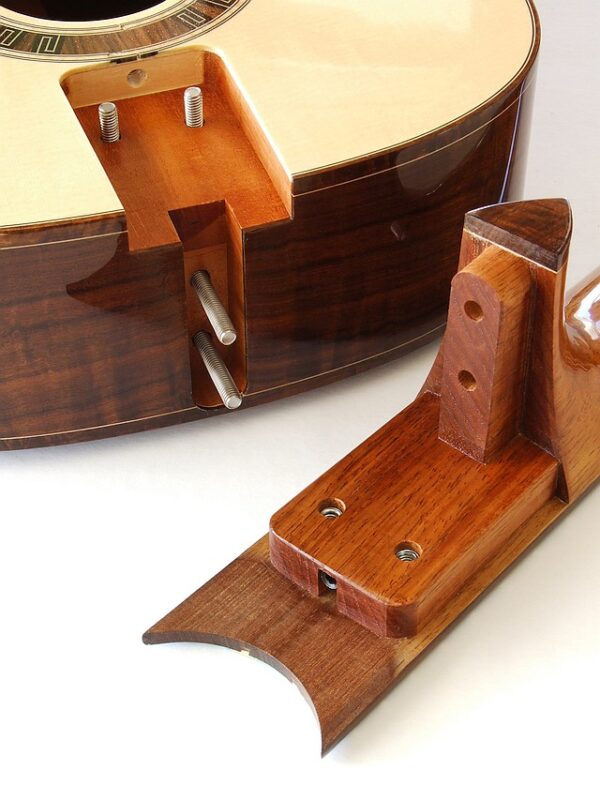

Sorry to hear about your troubles Brad. If I could make a suggestion about the future truss rods. . Blanchard makes the best rods hands down. give them a call because they can custom make any size and or specs. I have elec and acoustic rods from them. I also started utilizing spoke wheels on my bolt on necks. prob not what you want to hear now.
https://www.instagram.com/fostinoguitars/
https://www.facebook.com/PuraVidaUkuleles/

Yes, I’ve heard good things about them…
But I have gone back to the Martin style rods for good Other than them being a little heavy they are bulletproof…
