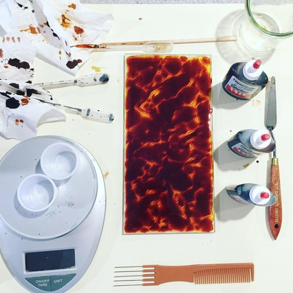

The Stew Mac Tortoloid Pickguard Material—Antique Tortoise— is pretty nice stuff. Always cut your own if you've up for it.

Or, cast your own from epoxy.

dpetrzelka wrote:
Daniel, what epoxy do you use or does it matter? I'm thinking of trying it with z-poxy. Because I have some on hand.

Dave, I'm far from confident in my approach, still very much in discovery phase. I've tried a more flexible Resin Research Epoxy 2000, but don't yet have the color bleed control that I'd like.
If you've got some Z-poxy it would definitely be worth a try.
Keep it about as thin as you can.

I made one with Z-Poxy for a giveaway for my friend's kid. It turned out pretty well and looks good three years on but if I was doing it on one for sale I'd use something harder. The Z-Poxy cured a little soft/rubbery for my taste.

Are there directions somewhere on pouring your own? One classy maker I know of routs a spot on the top, glues in a pearl inlay, and pours right over. End result is an inlaid pick guard with an inlay. Love to try that.
Any body have a sequence or a must-do or must-not-do list?

[quote="Any body have a sequence or a must-do or must-not-do list?[/quote]
No tips for an inlayed pick guard but one thing you'll want to do if pouring your own is to make sure you get all the bubbles out. I used a little acetone in a preval sprayer to mist the surface a couple of times. This breaks the surface tension and gets rid of nearly all bubbles. If there are any left, they'll probably be few enough that you can pop them individually.
