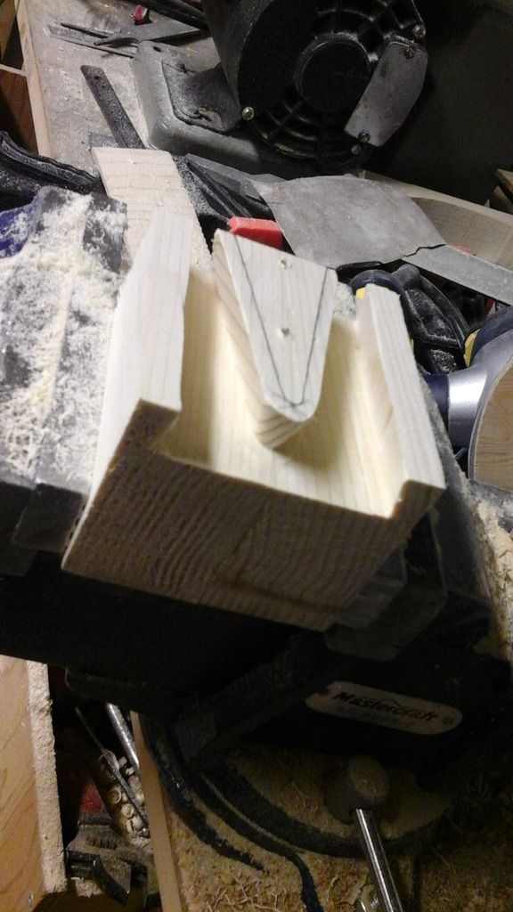

I will be using a 2"x6" stud for the neck. Cut two sections and glued them together. This will be a nylon string.

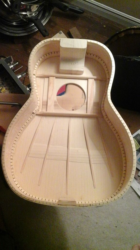

Neck block out of a piece of 2"x4", same with the linings. The original idea was to use common materials that anybody could pick up from their local big box retailer.
Maple binding.

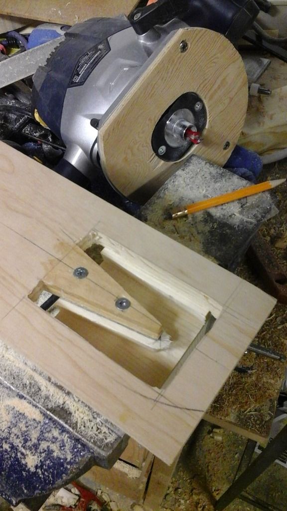

Trying to figure out how to do a dovetail joint, never done one before. I could not find the bottom plate of my router, made a quick one out of plywood.
So far so good.
The body jig. Showed using a square and caliper to find the center of the upper bout. I did not trust where the sides met and I was unsure if it was semetrical. Built it without a body mold.
