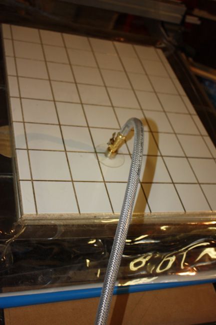

I put a V2 together last week to be used and shared in a community workspace I belong to. We filmed it's maiden voyage. This link should take you directly to it: First time using the V2
I was just gluing some cork to a work holder for binding (ala Todd Stock), but hey, why not have some fun with the new toy. [:Y:]
It pulls 25" on our compressor. You'll see 15" on the dial in the video if you look closely. I realized quickly that the quick connect fitting was pulling the bag's stem connector open. After wiggling the hose around, everything was fine and it pulled 25".
One thing to keep your eye out for . . . There are two links to kit instructions on the V2 page. One takes you to current instructions, one takes you to outdated instructions. Guess which ones I used first? I couldn't figure out why my V2 was blowing air rather than pulling it. Follow the first link, not the second.

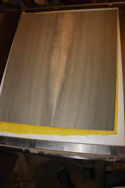

I used my V2 from Joe's for a double-top J45 of Lutz inner and outer with silk in the middle. At .100 you can stand on it. The silk really adds strength.

So just regular fabric silk? What an interesting idea, it allows you to keep the top thin unlike nomex. Fascinating!
Image Image
Bob
Very cool. What glue did you use?
PostPosted: Mon Sep 05, 2016 1:15 pm
Joined: Tue Mar 04, 2008 11:55 am
Posts: 566
Last Name: Shanklin
City: Windsor
State: ON
West System epoxy.
