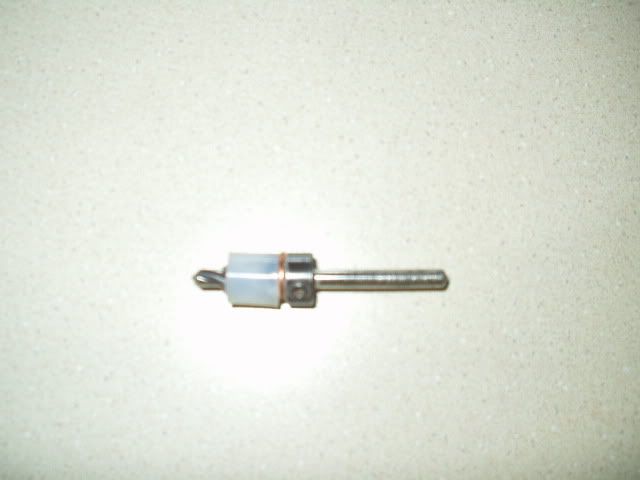

I use a standard 3/8" counter sink with 3/16" pilot -- the trick is to make a stop, I used a piece of nylon spacer CA'd in place, works great and not $35 --- if you know what I mean.

David Collins wrote:
I'm a big fan of zero flute countersinks for this job. Smooth finish, slow cut, no chatter.
I didn't know what it was called, but that's what I've always used--much smoother cut than fluted countersinks or carbide burrs.
These users thanked the author Eric Reid for the post: bcombs510 (Wed Apr 27, 2016 8:07 am)
