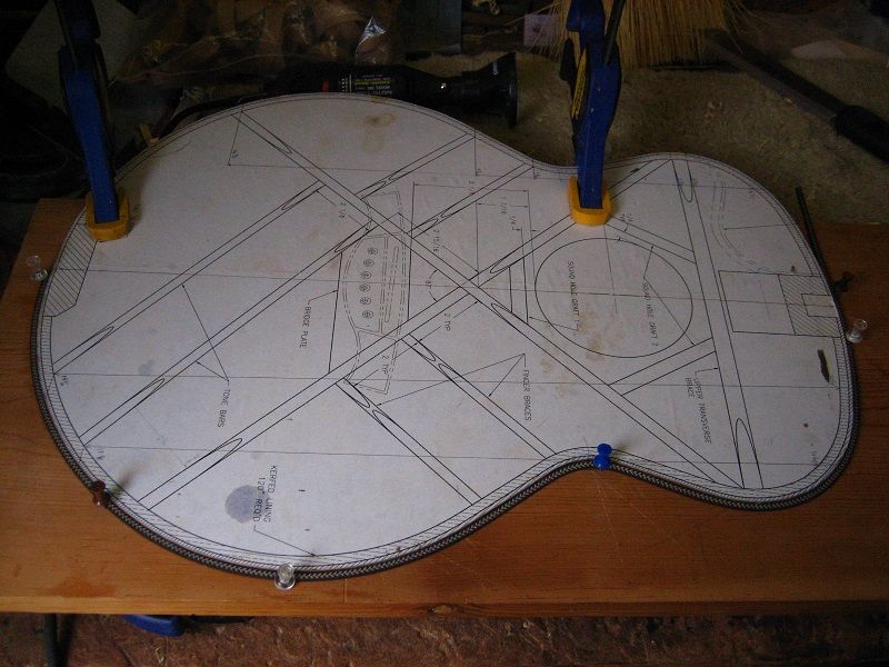

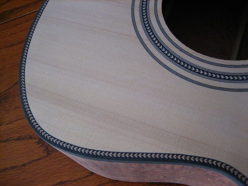

Going to be using herringbone purfling for the first time..
Anyone got any tips for shaping to body?
Should I use it dry on bending iron or soak it and try and shape it

Using my router, I cut a channel to the shape I want (the channel depth is slightly less than the thickness of the purfling) and then use a clothing iron (no water) to make it take the shape of the channel. I then press it in the channel for like 15 mins with a piece of plywood or something.

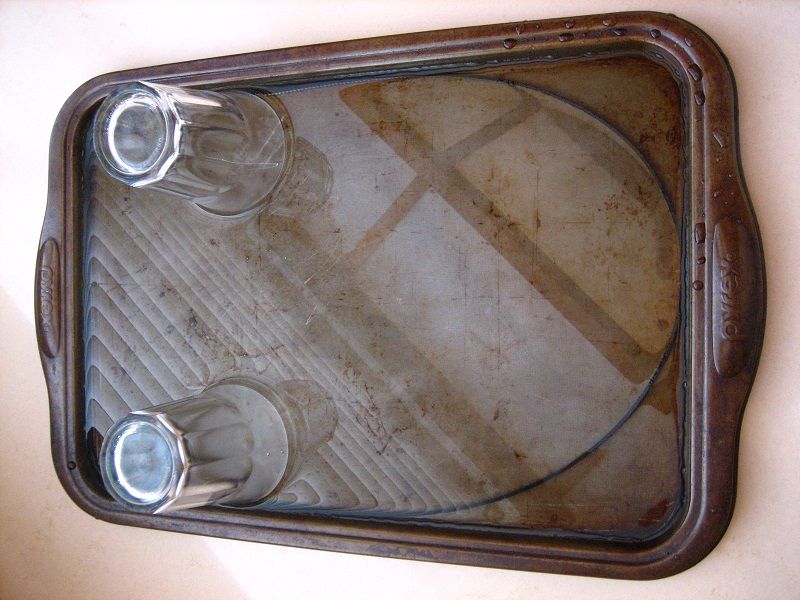

I have done this many times. Soak for 10 minutes and bend to form. Let dry and that's it.
