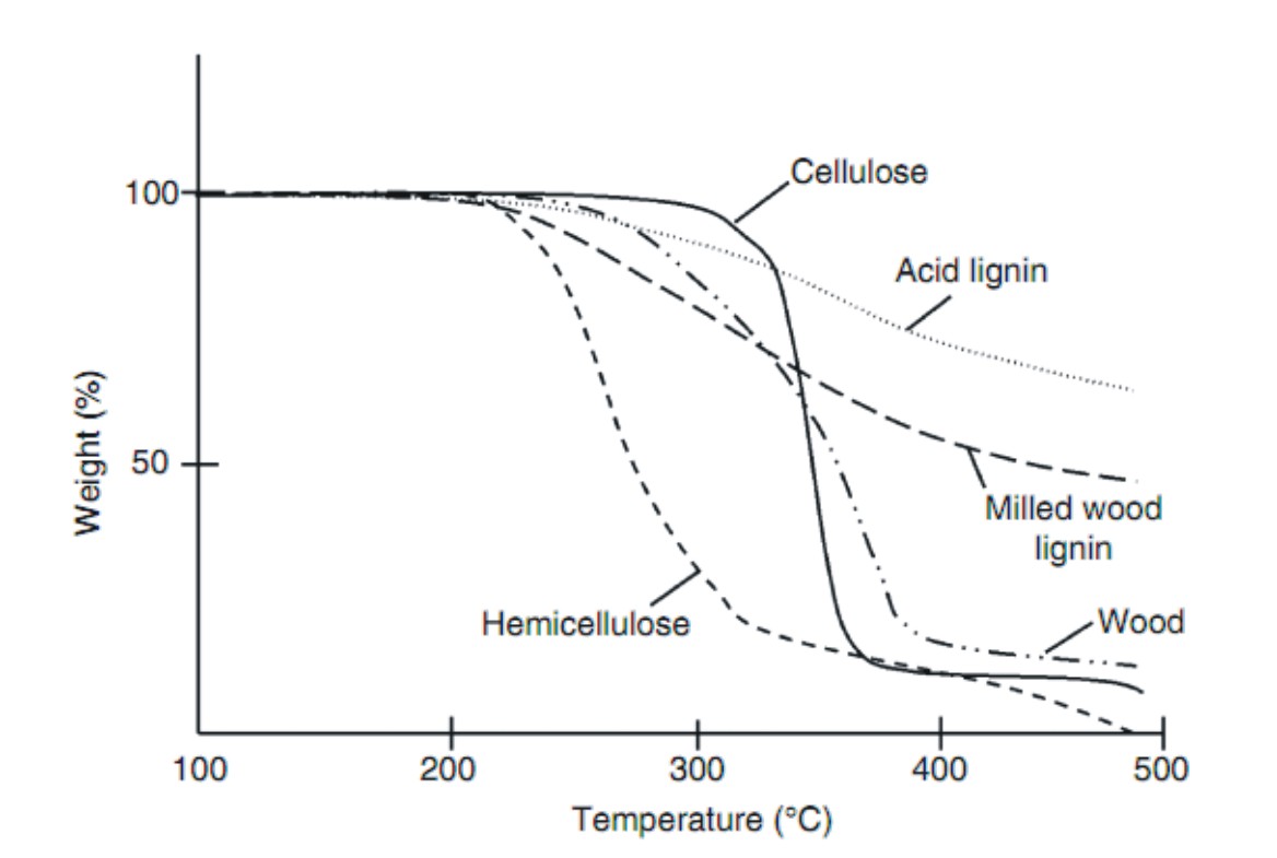

The exact details are contained in Yamaha's patent application for their A.R.E. process. See: http://www.google.com/patents/US6667429
The basic process is to use an autoclave that removes the oxygen and heats the wood to about 400 degrees using live steam.
A lot depends on the end result you're after. For the sake of discussion, let's assume that torrefaction 'ages' wood. So, the longer you leave the wood in the autoclave the more it 'ages'.
Martin has two levels of torrefaction, M1 and M2. The M1 wood is what's used on their VTS guitars. It is left in the autoclave only long enough to 'age' the wood so that the degree of crystallization 'matches' that of wood from the period that they're trying to duplicate, let's say 1937.
When wood is lightly torrefied, such as the Yamaha A.R.E. or Martin M1 process, the wood doesn't discolor very much, if at all. Also this wood is semi-translucent. Not as translucent as new wood, but not as opaque as 200+ year-old wood.
The torrefied wood sold by Stewmac, RC Tonewoods, Colonial, Blues Creek, etc. are more like Martin's M2 process which is in the autoclave for a longer period of time. This makes the wood darker and completely opaque.
Martin does sell one guitar with M2 torrefied Adi spruce. See: https://www.martinguitar.com/guitars/limited-editions-and-new-models/d-35e-50th-anniversary-limited-edition/

Why would they be the same, we have enough variability in non-treated tops and we do not expect them all to be equal. Can we test the untreated tops and have a simple measure of their worth?
Wood is a complex material. The process changes this material. The time, temperature, amount of moisture present all change the reaction going on. One graph of torrefaction that I found.
The lower the temperature the less hemicellulose gets lost, the higher looses more. But then you start removing the other components. Given the time and temperatures that a guitar top processor uses will you be able to determine how much processing changed the wood? I would not be able to. Is there a graph comparing the processing at 375 F for two hours as compared to 385 F at one hour? The processors may have one, you and I, fat chance. At best we can compare their final product compared to other products.
I have worked in two industries where we take the raw material and cook them to change their properties. We had schedules that were found to work and followed them. That does not mean that a different schedule would not work and produce a similar result. We also sampled the material and modified the schedule if we found the raw material was different than the one originally used to set up the schedule. We also had different schedules to produce the product with a different 'flavor'.
