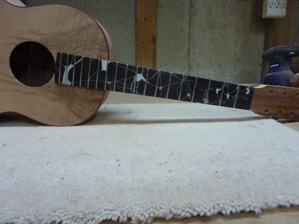

Last week I posted a question about how to do an inlay representative of neurons. This is just an update. I settled on using a casting resin called Alumilite. I routed out the pockets and just poured it in and it cured to a hard, white plastic. I used four different router bits, the smallest being 0.02" diameter to get the tapering of the axons. Here is the result:
I think it looks pretty good and my son (for whom I'm making this Terz guitar) is happy. Incidentally, with reference to the other post about whether or not to bind fretboards, I usually do. However this is one fretbooard I did not bind as my son felt it was more important, and I agree, that the neurons extend right to the edges of the board.

That looks really great, Pat. Did you route the inlay by hand using a template or just freehand? I'm curious about the process.

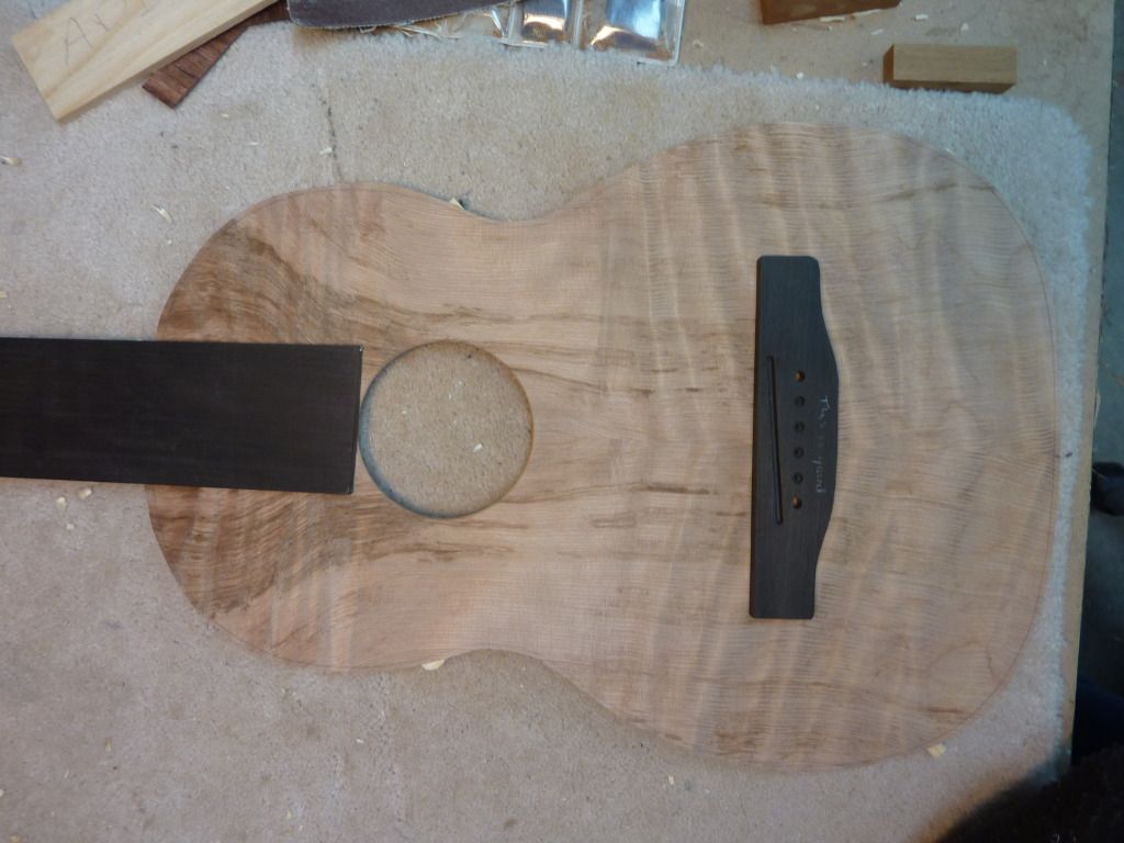

I think the inlays look great, Pat! To stray a little, what kind wood is the top made of? Almost looks like a little blue or ambrosia staining in the swirl.

The process was that I sent my son a pdf of the fret board and he sent it back with the neurons artwork. I'm not sure where he got that or how he arranged it. I do my inlays with a pantograph so I enlarged what my son sent me to three times actual size and traced that with the follower on the pantograph which made the dremel cut the pockets at actual size into the fret board. Using a pantograph to accurately replicate the artwork really wasn't necessary since the "inlay" was just a resin that was going to fill any pocket shape I made. I mainly used it just because I have it all set up and ready to go all the time so that was just the easiest thing to do. I started with a relatively large 3/32" router bit for the "bodies" of the neurons and worked my way down to a 1/50" router bit for the finest axons. Once the pockets were cut I just mixed up the resin, poured it in and there you go. It's actually a pretty easy way to do inlays.
The top is curly redwood, Alex. My son picked the set specifically because he love the black streaks in the wood. That's also the reason he opted for no rosette - he didn't want the black streaks going around the sound hole to be interrupted. Here's a picture of the whole top:
