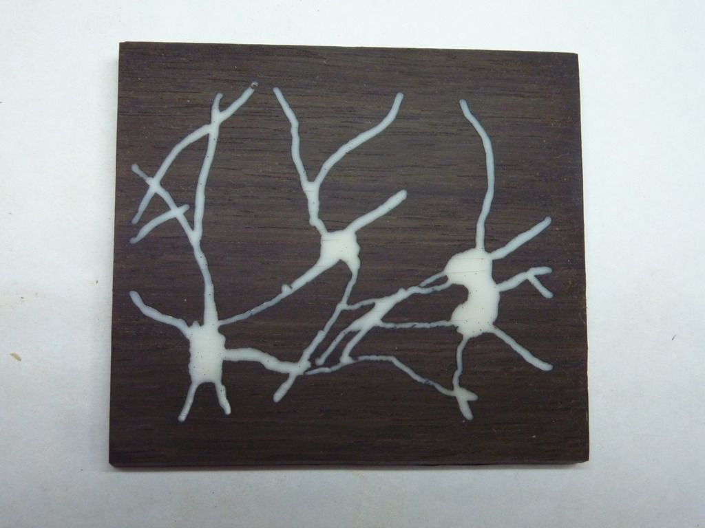

Thanks again for all your suggestions. Alumilite was available locally, Inlace was not, so here's the result of my test inlay using Alumilite resin:
It looks pretty good I think. If you have it on your screen larger than life you may notice a few horizontal lines left over from sanding. I wouldn't leave those on a fret board. There's also a relatively large bubble left over at the end of the top left axon. It's actually pretty hard to see in real life but I would probably try to fix one of those if it happened again. I'd try to do better at finding and "popping" those prior to cure. If you really blow it up you can see that there are lots of little bubbles. I gather that to not have those requires sticking the whole thing in a pressure pot while the resin is curing. However as I can't see these bubbles in real life, they are smaller than the pores in the surrounding wood, I'm not going to worry about them.
I also "de-molded" the cured "puck" from the bottom of the mixing cup. It feels like a reasonably hard piece of plastic. I went through the exercise of rough sanding it then sanding it smooth and eventually buffing it until it was shiny just to see if I could. It was easy - which is actually an indication that it's not all that hard. It's definitely not as hard as the polyester I use to finish guitars.I can mark it with my thumb nail. However I also tried rubbing guitar strings on it, pressing harder than I would if I was just fretting a note, and that did not leave any marks. So I think it will work but at the same time prudence would suggest not to put a big blog of the stuff right in the spots where fret boards get the most wear.

One more thing to consider...titanium dioxide.....the whitest of whites. If you can get access to some, try it in slow set epoxy. It's used primarily as paint pigment and in it's produced form it is a superfine powder. I could try to send you and ounce or two if interested as I have access to tons of it.
How about filling the spaces with titanium dioxide and then shooting it with CA? I like the look of the design as one piece rather than multiple segments. Mind you I might like that if I seen it also.

That does look pretty good Pat. I was going to suggest reconstituted stone but the more I thought about cutting the stone and doing the inlay with that much intricacy and continuous pieces I'm thinking go with the resin.
