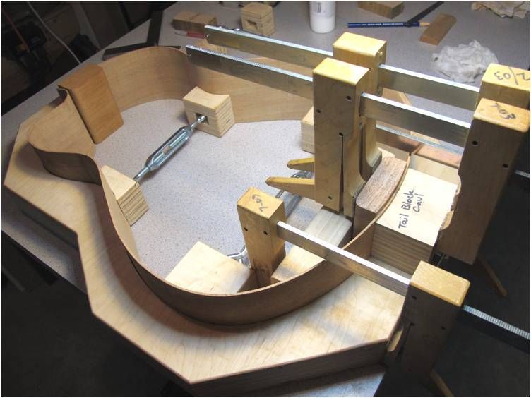

The tail on my guitars has a radius just under 9 inches. I draw the arc on both ends of the tail block and sand to the lines on the belt sander.
For clamping, I use my outside body mold and a caul. With the sides and tail block in position, the mold is pushed down to the benchtop surface and the caul with the same radius rests on top of the mold. Clamped as in the photo.
Here's the general approach I use to make radiused cauls for radii 12" or less. On the band saw, clamp some type of pivot point to the fence so it's aligned 90 degrees with the cutting edge and position the tip of the pivot the distance of the radius from the blade. Hold a block centered on the pivot point and then sweep it through the blade. You get both convex and concave surfaces of the desired radius.
