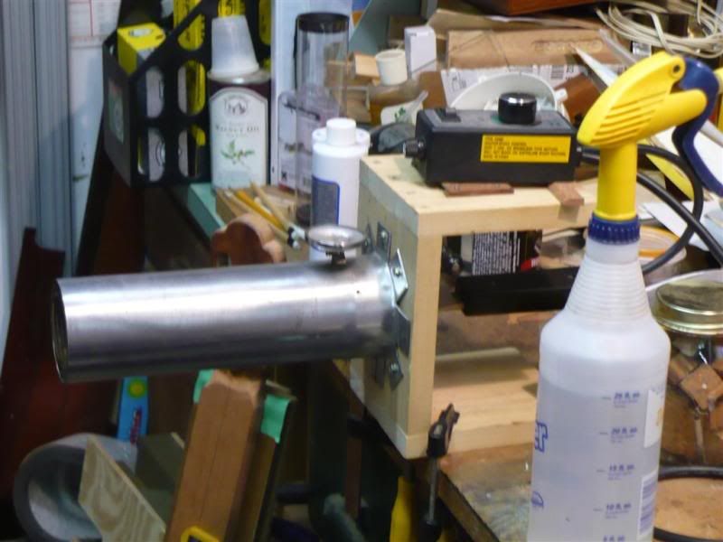

We use the pipe bender described in this thread almost every day -- read the entire thread, timer, controller and temperature senor are important and simple and inexpensive to fabricate as well.

We did used a propane torch set up for many years --- I went to the electric element after what could have been a very bad incident. I had let a good friend of mine use the pipe and benders for his project. I was in the shop at the time, but never thought to check the propane torch -- I discovered the next morning that the torch still had a low flame burning over night. That reminded me that I had a "good memory but it is short"
For me it usually safety first with timers and shut offs --- took this to get me off my butt and modernize the pipe bender a little.
Ken Cierp

Ken, my dimmer, outlet and timer are set up pretty much just like yours. Each time I plug it in, I always wonder if I turned it off last time or just let the time run out. The night light is genius in its simplicity! No more coming back a few minuets later and realizing it didn't heat up.

Thanks Bryan -- I looked at an outlet with a pilot --- $$ yikes!
I think someone above mentioned it already -- but the blanket cannot be free standing it must be against a heat sink or it will burn up very quickly.
Ken Cierp
