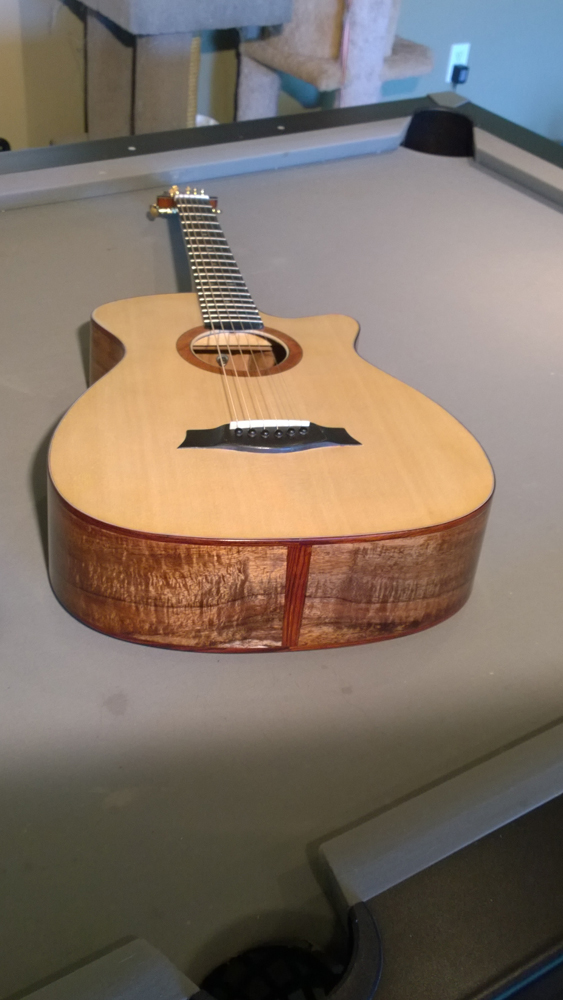

I had a real classical guitarist try out my two falcates, one classical one steel string, and posted some excerpts on sound cloud. Hearing the guitars inspires me to keep pushing. My next will be another falcate classical. I will work to get the top about 10 hz higher than this one. It is being built as a commission for my classical guitar instructor.

Nothing beats putting your guitars in the hands of a skilled player, does it? To my ears both of these instruments offer a nice, open tone with lovely trebles. Out of curiosity, what is the expected result of raising the top 10hz?

A lot of the X brace guitars, not all, have strong basses good trebles but the middle voices drop out. I have found my falcate guitars have more balance across the string and through the registers than I achieved on my X braced guitars.
What I heard from both the classical players and steel string players is that they find both guitars have great volume, follows quickly dynamically (relatively low mass top), good balance and clarity of the notes on all of the strings, really good sustain. All thought both guitars had a good voice.
Right around the 1st string 10th fret that trebles start to weaken. In Falcate Classical A when the high note E on the 12 fret is played it should be an event. It is less so on my guitar than it could be. Having the top pitched a bit higher would better support the trebles.
