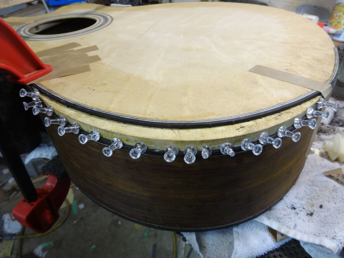

I use map pins as shown in Kent's video one of the tings I learned from it that made my arm bevel technique better.
As for bending the binding down into the bevel area a smooth transition and supersoft II makes it easier.

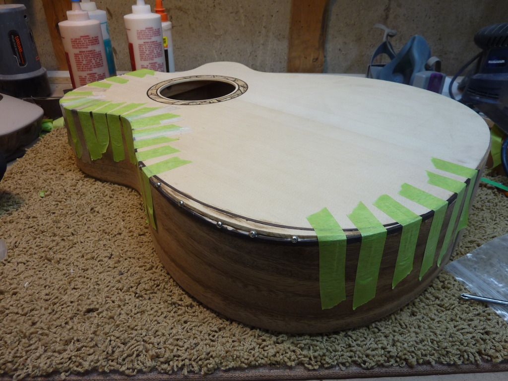

I figured out my way, and its just like Fred's ... extra binding on top for the veneer to sand into ... always looks good !!! I use fish glue, and wrap the veneer on after taping it in pace with surgical tubing .. the long set time plus the pressure from the wrap means the veneer always sits down tight ...

Before I used screws, I used pins. I found it difficult to push them all the way in without drilling a hole for them and when I drilled a hole for them they didn't pull the binding in tight. Perhaps I just need a smaller hole to get more friction. Regardless, screws are working well for me.

Pat hammer them in at an angle, that trick plus cutting the bevel shape into the side before the kerf lining and wood core and cutting the top for the bevel before gluing to the sides was worth the price of the dvd.

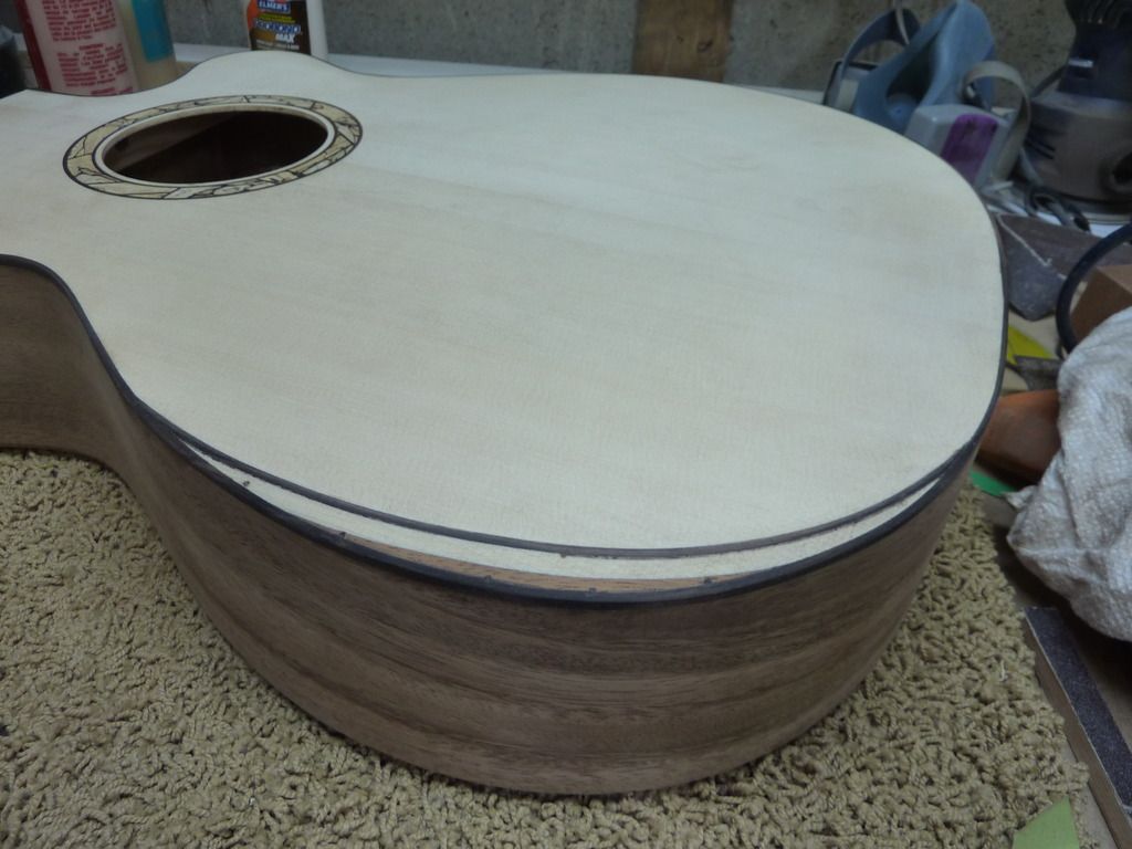

For what it may be worth, here are some pictures of an arm-rest I recently completed:

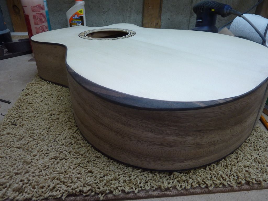

This first picture is to show that I did not go very low with the binding below the arm-rest and that I used screws to both keep the binding down in place and pull in its top edge as it wants to flare out.
After rasping and sanding the corner away. It is important to fill in the holes left by the screws prior to putting on the veneer:
The finished arm-rest. It is about 1 cm wide at its widest point:

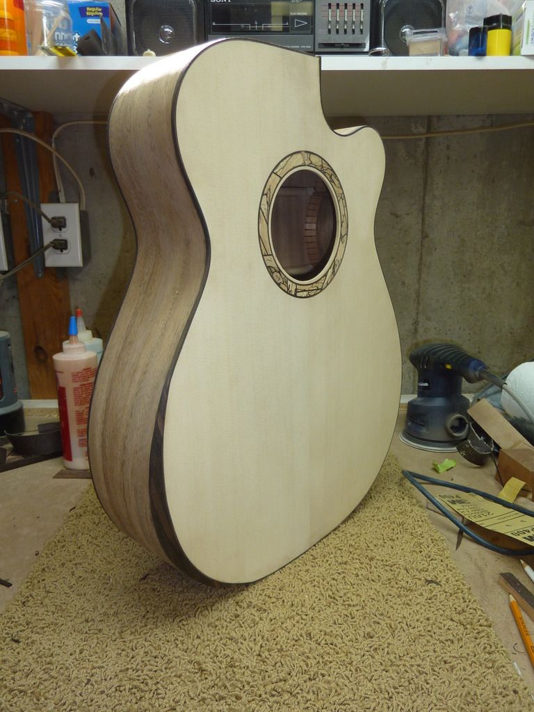

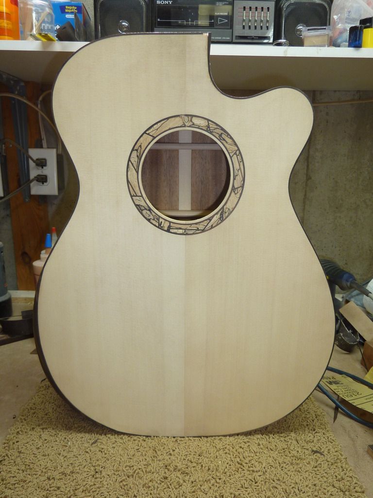

Front view of guitar body. The binding is thicker up by the neck joint area because I'm doing a contoured cutaway so the router went deeper in this area. I knew this would happen and put in a wedge of binding to fill the gap. This will all be under the finger board:
Three-quarter view of guitar body:
This might not be to your taste, but an arm rest of this size, i.e. going this far down into the side, is functional and not too, too hard to do.
