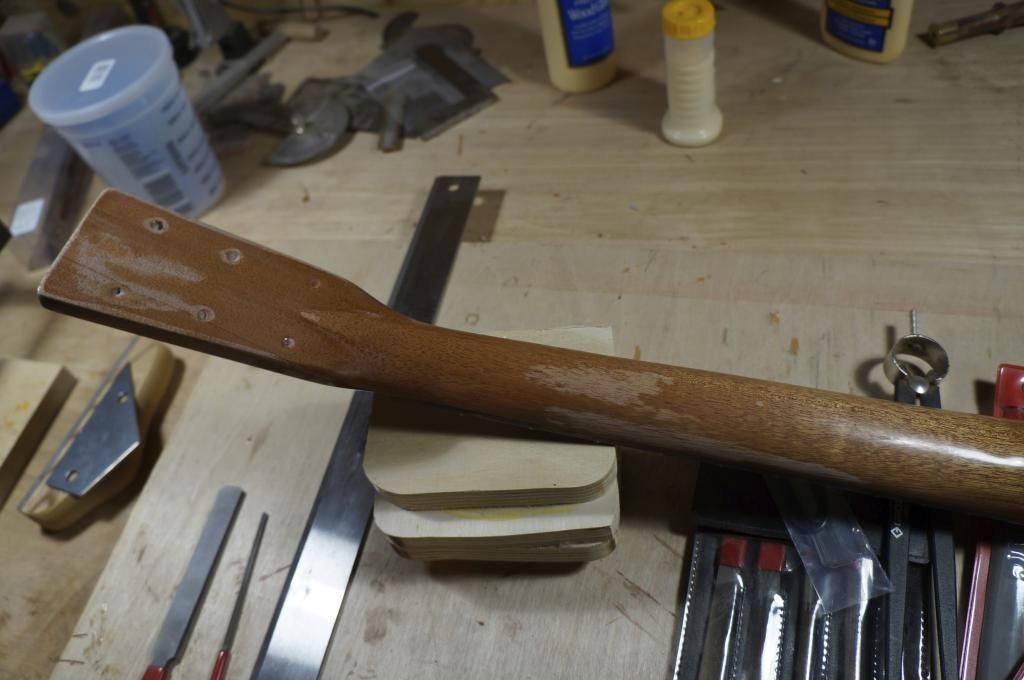

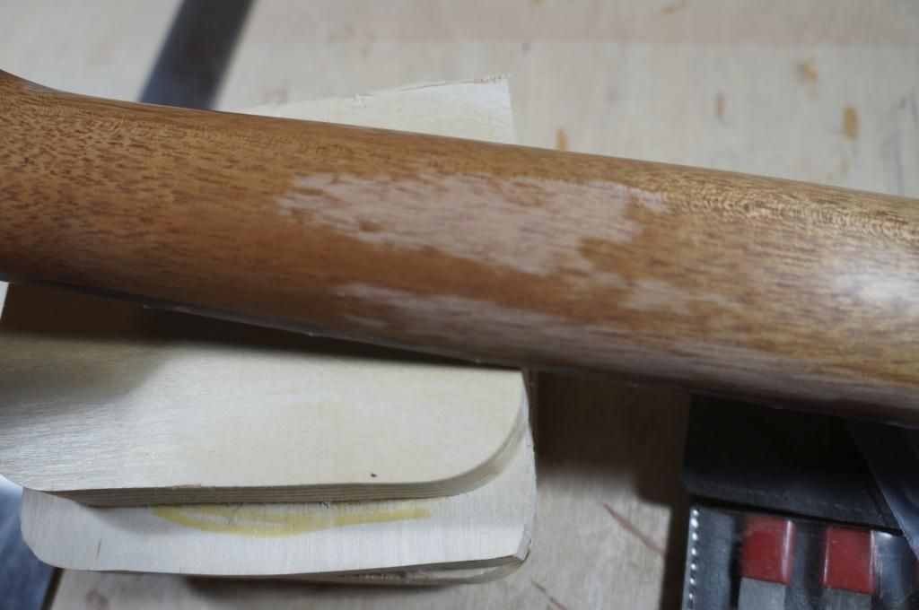

Anyone recognize what this may be? It only appeared at buffing. My first thought was I was overzealous and burned through, but I doubt it. It appeared at first light buff, and I was much more aggressive on other places that are fine. It is mahogany filled with timbermate, and has 10 coats of KTM9, followed by a 10 day set. It looks like its something spilled on the bare wood level, but then again, everything looked fine until buffing. Unless anyone has a different suggestion, I'm just going to scratch my head a little more, then sand it down and refinish. Puzzling? I do admit that the pattern around the edge of the headstock really makes me think of overbuffing, but not the other patterns?
PostPosted: Sat Jan 10, 2015 5:25 pm
looks to me like there is no finish left in those areas ...the lighter edges are a dead giveaway ...
These users thanked the author TonyKarol for the post: Rod True (Thu Jan 15, 2015 3:01 am)
PostPosted: Sat Jan 10, 2015 5:29 pm
Posts: 3005
It looks to me like you buffed your finish off. Wipe some naptha on it and see if it blends back in, if it does you definitely buffed through.

Hard to see in the picture but if there is finish on those spots the finish is lifted from the wood.
PostPosted: Sat Jan 10, 2015 5:45 pm
Posts: 2951
Last Name: Beaver
City: Lake Forest
I agree, probably sand through. If not then delamination of the finish from the pore filler.
if I was a handicapper I'd put it at 95% chance of sand thru, 5% chance of delamination.
(also a lot of sand thru on the head stock.)
10 coats of KTM 9 is on the light side unless they were very heavy coats. If they were that heavy you would most likely see a hazy, blue cast finish. But wait, that is good news!!! It is much easier to spray more coats than deal with delamination issues.

On closer inspection, I have to agree on the sand through. I thought it would be easier to tell, and probably is to more experienced eyes than mine. I guess I probably thinned things down with sanding, even though I thought my arms would be rubber before I sanded through with the fine wet sanding. Live and learn.
Thanks for the comments--as always, this forum is a tremendous help!
