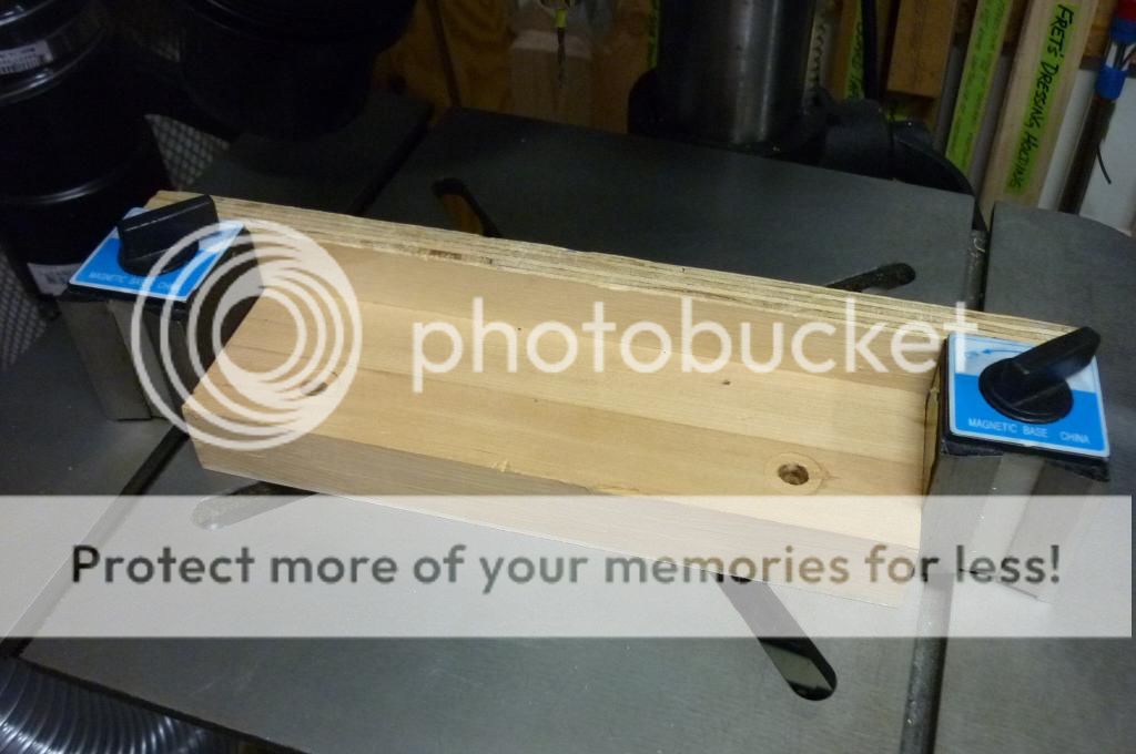

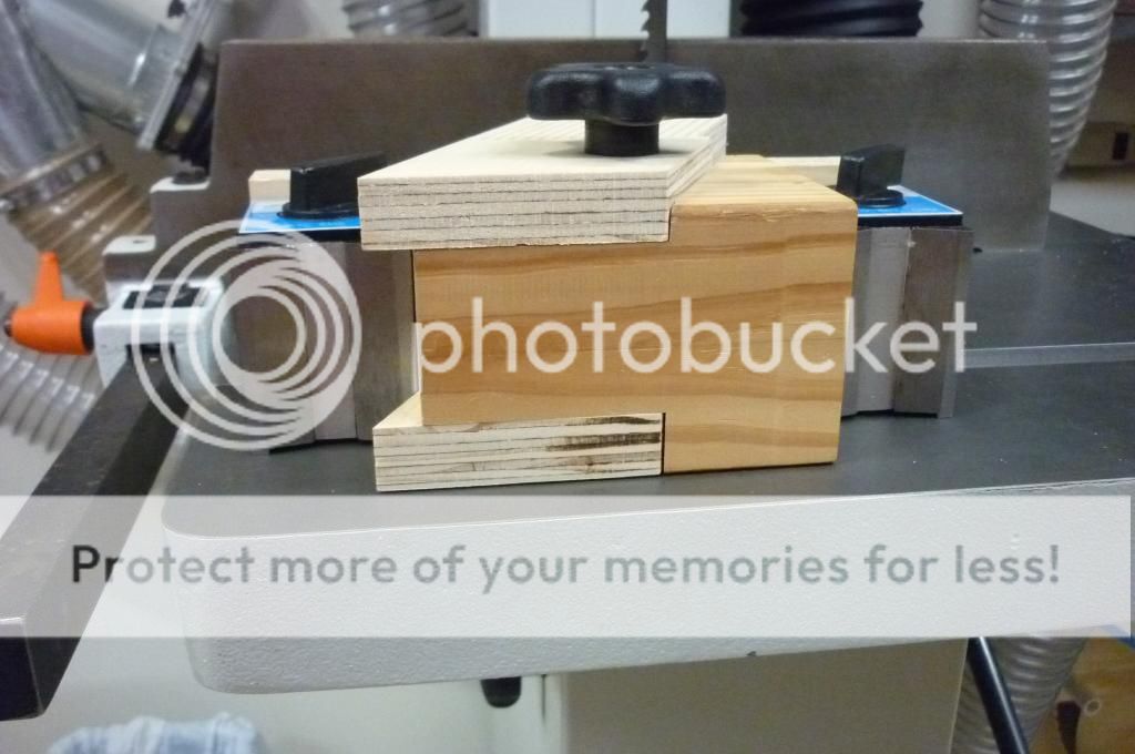

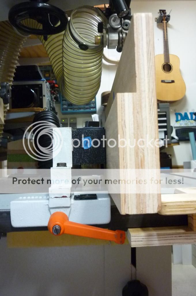

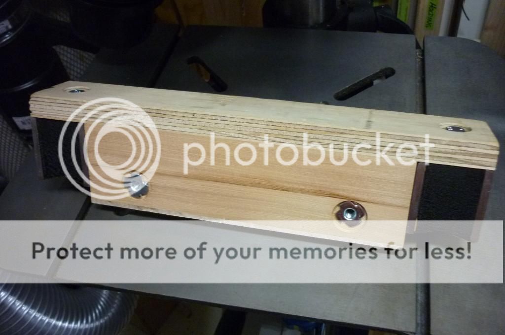

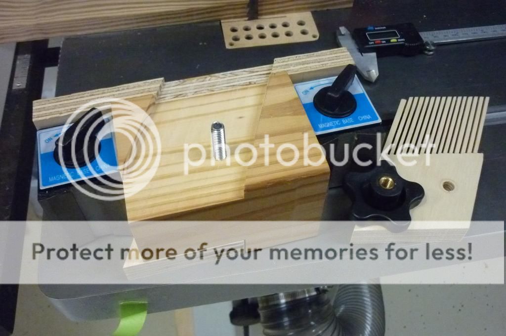

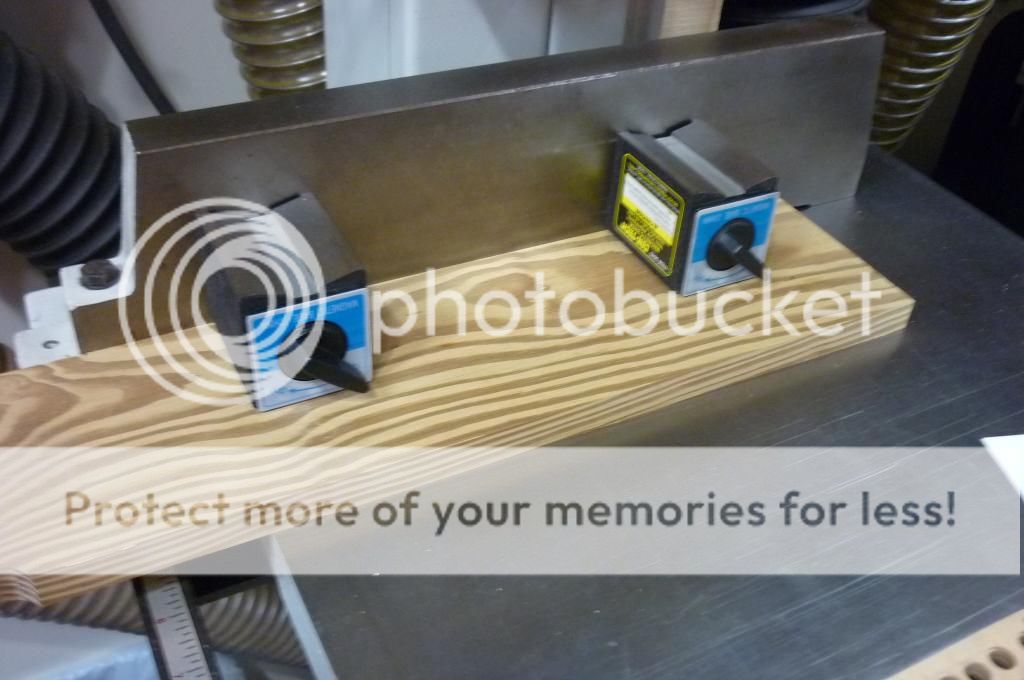

Switchable magnets are not new. But maybe some of these uses will be of help to someone. They have been for me every day.
Here is a magenitc feather board. I paid about $7 for each switchable magnet at Harbor Freight. I can position this very exactly and very quickly - once for each repeated cut if needed. It makes for very consistent cuts and is also a safety tool since it keeps my hands and fingers far from the blade. Often the feathers are within 1/4" of the blade when cutting thin veneers and bindings. When not needed one of its magnets holds it within reach on the bandsaw frame. Cutting each of the first feathers 1/8" short allow for easy accurate placement of the wood inside the first feather without any tension. (I found that using miter slot secured feather boards was very slow and often could not be positioned easily.)
This is a magnetic low fence. Often my regular fence is too high for small or thin items. The low fence lets me lower the guide bearings much lower closer to the wood and gets the regular fence out of the way of my hands. The magnets stick to the regular fence, not the table, so that I can postion the low fence by moving the regular fence and tightening it down. This keeps it completely square and easy to position accurately. It stores on the frame too, but I find I use it more than the regular fence.
Here's a magnetic drill press fence and clamp holder. It has two fences of different heights depending on which way the fence is turned. It also has two tee nuts that can secure hold down clamps for clamping small items. I use this a lot to increase drill press accuracy. I can clamp my fretboard to the high fence and drill side fret markers very accurately.
This is a magnetic high fence. I use it mainly for resawing back veneers. The magnets stick to the regular fence so that I cam move the high fence by moving the regular fence. I can easly adjust the regular fence accurately by a few thousands, which makes small accurate adjustments for resawing back veneers. Note the pieces of paper used as shims under the magnets to achieve a perfectly square fence to the table. The two 3/4" pieces of plywood laminated together make for a very stable and stiff high fence. The magnets are staggered to increase stability.
