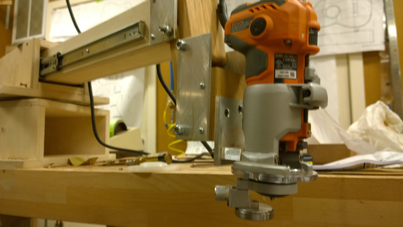

I really like their stuff. I was wondering if it made sense to attach this device to a
Williams binding jig :
http://www.luthiertool.com/binding%20cutter.html
I've seen (but cannot find) pictures of Williams jigs outfitted to use spiral downcut bits. I'm interested in doing this.

I don't see why. Your sides would have to be amazingly square to cut consistent depth.

"I don't see why. Your sides would have to be amazingly square to cut consistent depth."
My main reason is to not have to use bearings and rabbit cutters. They are "violent". If I for a moment forget the correct path direction (its happened), well, you know what can happen. I like the binding jig design above. But I don't care for the freehand part of it. Fixing it to the Williams jig may screw up the concept.
Of course my sides are amazingly square! laughing6-hehe

Right. I agree. I want a an out of the box ready solution to convert my williams jig to down cut bits. Right now, and for some time now, my mood towards self built jigs etc has waned.

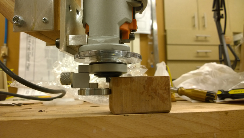

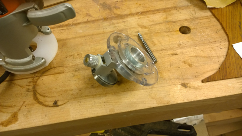

I have a Luthier Tool binding cutter. It can be adapted to nearly any router and jig set up as it mounts in the routers guide bushing hole. I adapted my Fleishman binding machine. Should be the same with a Williams.
I have used it on three instruments and have been very happy with it. I have had even channels cut with is. The Fleishman jig holds the router square. The index wheel on the cutter works really well.

While it is true that the rabbit bit and bearings produces a perfect depth of cut every time, this doesn't mean that there aren't other options that also work equally as well.
Both Larrivee and Taylor both use a fixed "bearing" surface with a cutter and move the guitar body instead of the cutter. The binding jig that Josh House at Canadian Luthier Suppliers is the same style and system as the Taylor and Larrivee system.
Mike, I'm sure you can set up the system you want. The important thing is to remember that with the down cut bit, and independent bearing system you have to keep the guitar edge perpendicular to the cutter. This takes some getting use to and honestly you'll have to check the channel a few times and go over the channel a few times also to get it right. But once you've gotten the hang of it, it won't seem that much different that the rabbit bit set up.
An important factor with the down cut bit and independent bearing is to ensure the bearing diameter is larger than the cutter by a good margin (1/4" bit with a 3/4"-1" bearing would be ideal), this way when running the router around the body the cutter will never fall deeper into the body (channel depth) than it would with a smaller bearing.
I've done both ways and like everything else with this craft, it takes time to get the hang of the procedure.

I have one of the LT binding cutter and it is an amazing piece of equipment. You get what you pay for.

I purchased the Luthier tool jig years ago and agree that it's VERY well made and works great. I'll add that it's a real work of art with the machining, etc.
I did give mine away however favoring the William's jig and here's why. With this style of binding jig it's very possible to tip the thing inward and take a divot out of a gutiar top. Of course who would want to do this.... certainly not me. This is why I opped for something a little more bullet proof in avoiding opperator (me....) error.
There are at least a couple of threads in the archives of folks who tipped their jig of this style (there are shop-made ones too) inward and were sadly SOL.

Hi Joe, I have the original one, I guess it is the standard and yes thats the one on Mike's post. I did not know he had the others. I have had the StewMac BC but I think this one is just as easy and A LOT less set up time. Plus you don't have to deal with changing out the bearings. There is a little learning curve, but it is easy to get scrap lumber and practice your technique. I think he dropped the price of the standard. I think $205 is a deal.
