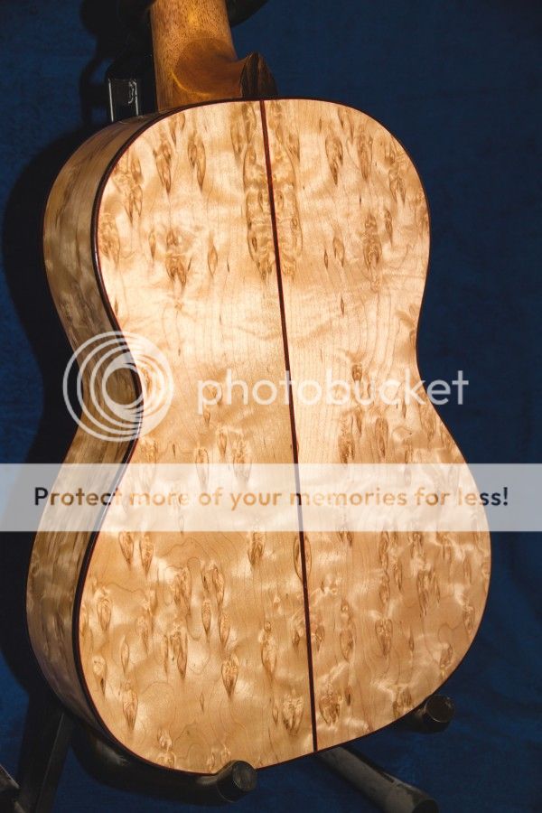

Colin is that second CL gtr pecky maple ??. Reason I ask is I have some very similiar wood in colour and pecky figure but it/s a local willow which I was cutting today . Thanks. Ps I noticed marcus on delcamp made the same error.If the caucasian spruce comes from a southern med climate.Guessing that is what some use for their bouzoukis , baglamas etc. I watched a number of videos by turkish makers and was wondering what kind of spruce they used ? they also hollow carve mulberry wood for their backs very interesting .As it (mulberry)grows here .
Ernie the guitar is Maple, I suppose you could call it Birdseye maple, though I think it was originally described by Bob Cefalu as Teardrop Maple due to it's unique figure. I bought it from Bob way back in the early days of the OLF for some ridiculously low price. I've never seen maple like it since.

Colin that back is gorgeous . I just luv it !, and it seems vy much like the pecky willow I got from my local sawmill. I/ve got muzaffa on my facebook list of friends ,Will have to break down and get some cypress, and C. spruce from him.Thanks for posting the pics , cheers ernie.
